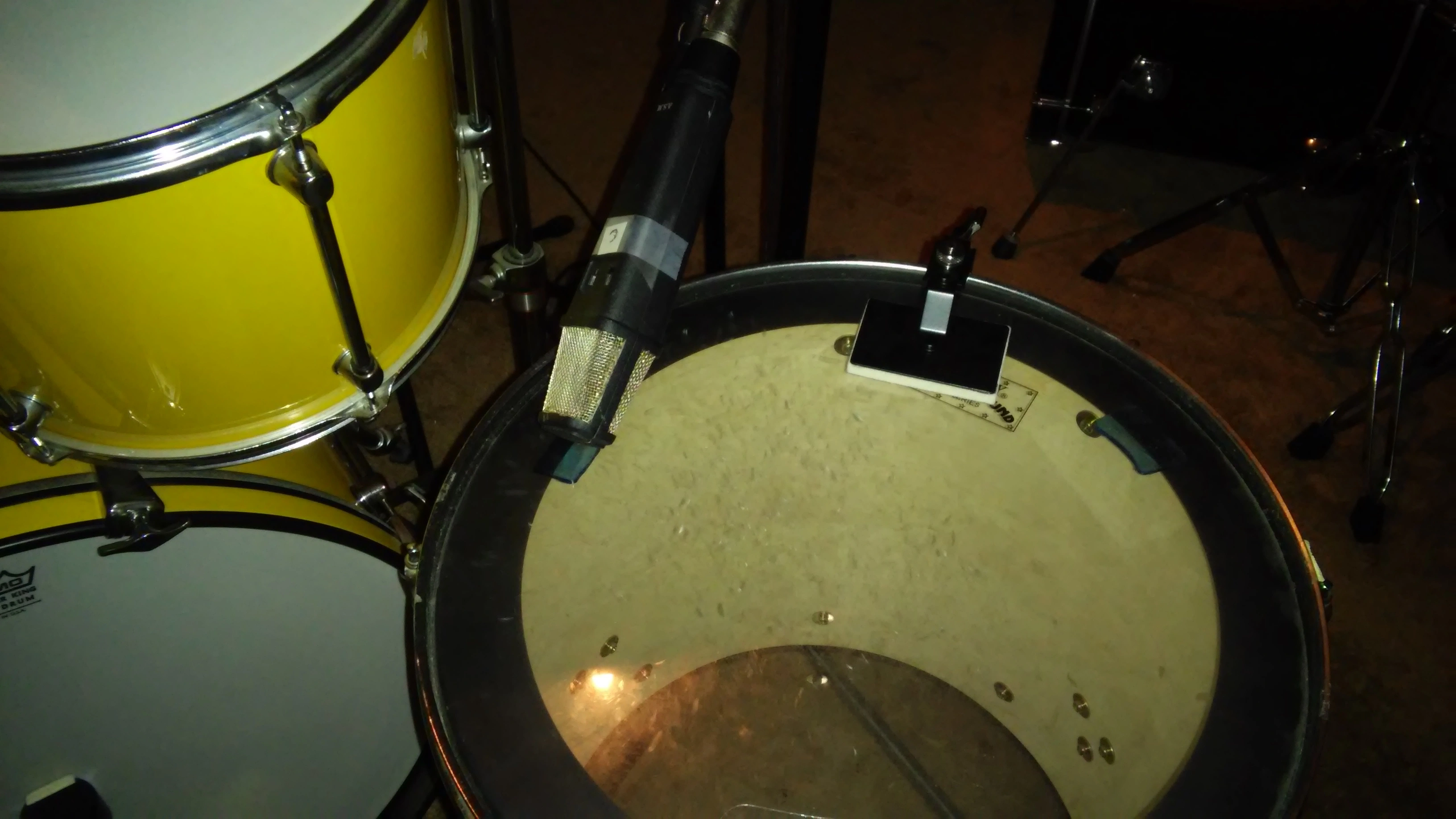

I love coming back to a thread I haven't looked at in days to see how far it has wandered off topic:p By the by I just moved my floor tom mic about three inches due to too many stick strikes(it's and mk219,slightly modded) and now my floor tom sounds like it's being pounded by Thor with Mjolnir. I had thought it was as good as I could get where it was, just goes to show. Here is where it was, it's now just at the floor tom rim tucked next to the rack tom.
