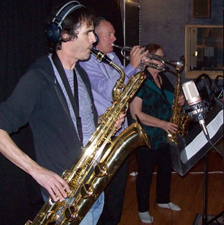

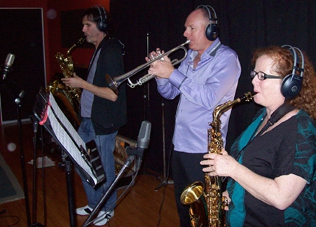

You know a lot of the sound is in the mic position, I have attached 2 photos, the Alto sax has a AT3525 condenser on it, notice that I did not point it directly into the horn as a lot of the sound comes from the body of the sax and I wanted to pick that up, the baritone sax has a AKGC4000B on it, also not pointed down the horn. We recorded the horn section together to get a live feel for the brass section. This positioning can be done with an SM57 so if you have been pointing down the horn point it more towards the body of the sax, you get a much warmer sound. The selection of mics in this case was to get the sound we were after, a soul hard hitting brass section, I could have also used SM57's and 421's on this and got a good sound but went for the condensers. If I wanted a more mellow jazz sound I would have probably use some ribbon mics on the sax's.
