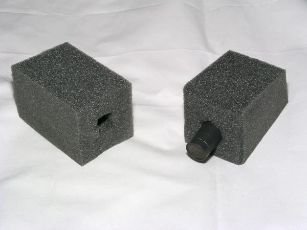

One of the easiest ways to mic a double-bass is to put the mic in a foam block behind the tail-piece. You need a directional mic, and I've had quite good results using this technique.
The foam mount behind the tail-piece, was just a convenient way of mounting the mic quickly, as I found that setting up and adjusting the rubber-bands was too fiddly in a live situation, especially if the lights were dimmed. The KM185 would also work very well on a stand with the mic pointing at the bridge, but then I'd have to be constantly aware of keeping the bass in the "sweet-spot", especially with a hypercardioid, so it's much easier to have the mic mounted on the bass (one disadvantage of having it pointing up is that it tends to pick up any noises or comments I might make, although I tend not be a "grunter"…)

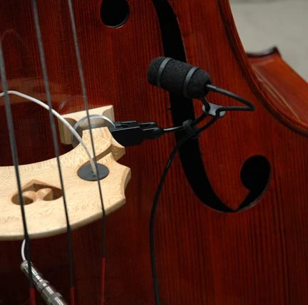

I have DPA 4061 which is a fabulous little mic - I Velcro™ mine behind the fingerboard of the bass - the problem with the 4061 is that it's an omni, and picks up everything, so it's hardly the mic of choice for a live gig, however in a studio where the acoustic isolation can be controlled, it is a great mic, and is tiny.
Here's a link to some recordings I made where the double-bass was being recorded using a Neumann KM185 in a foam-block behind the tailpiece.
Here are some pics of the foam-block and rubber-band technique, and also of an ATM-35 which I use occasionally.
