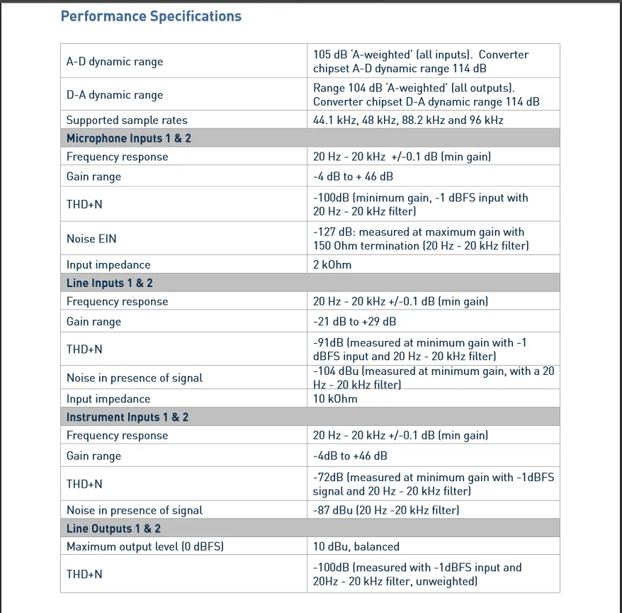

As far as input levels it says the following on the website, I also looked at the specs but didn't know what I was looking for really;
Use the front panel high quality XLR/jack combination inputs to connect line and instrument level signals as well as microphones – perfect for recording a synth or stage piano, or at the flick of a switch, an electric or acoustic guitar.

Should I set the front of the 2I2 to Line or Inst, if you look at the file I have attached it would seem that using Inst makes the most sense and it is louder than when I was using Line for sure. Would getting a TRS to XLR make any difference to the sound quality or am I perfectlt fine with the current setup?
Also when using Inst if I have the gain all the way up I have to turn down the output on the DBX 286s so that it doesn't clip, I have it set to +60 on the gain and then -10 on the output, although the focusrite still flashes orange and red sometimes on the led.

The output of the 286s is line level, so set the 2i2 to line level. If you used XLR into the 2i2 you would be going through the mic preamps in the 2i2 which you don't need to do with the 286s as the preamp. INST is for an instrument such as guitar or bass which has a high impedance and gain and would likely be unbalanced.
