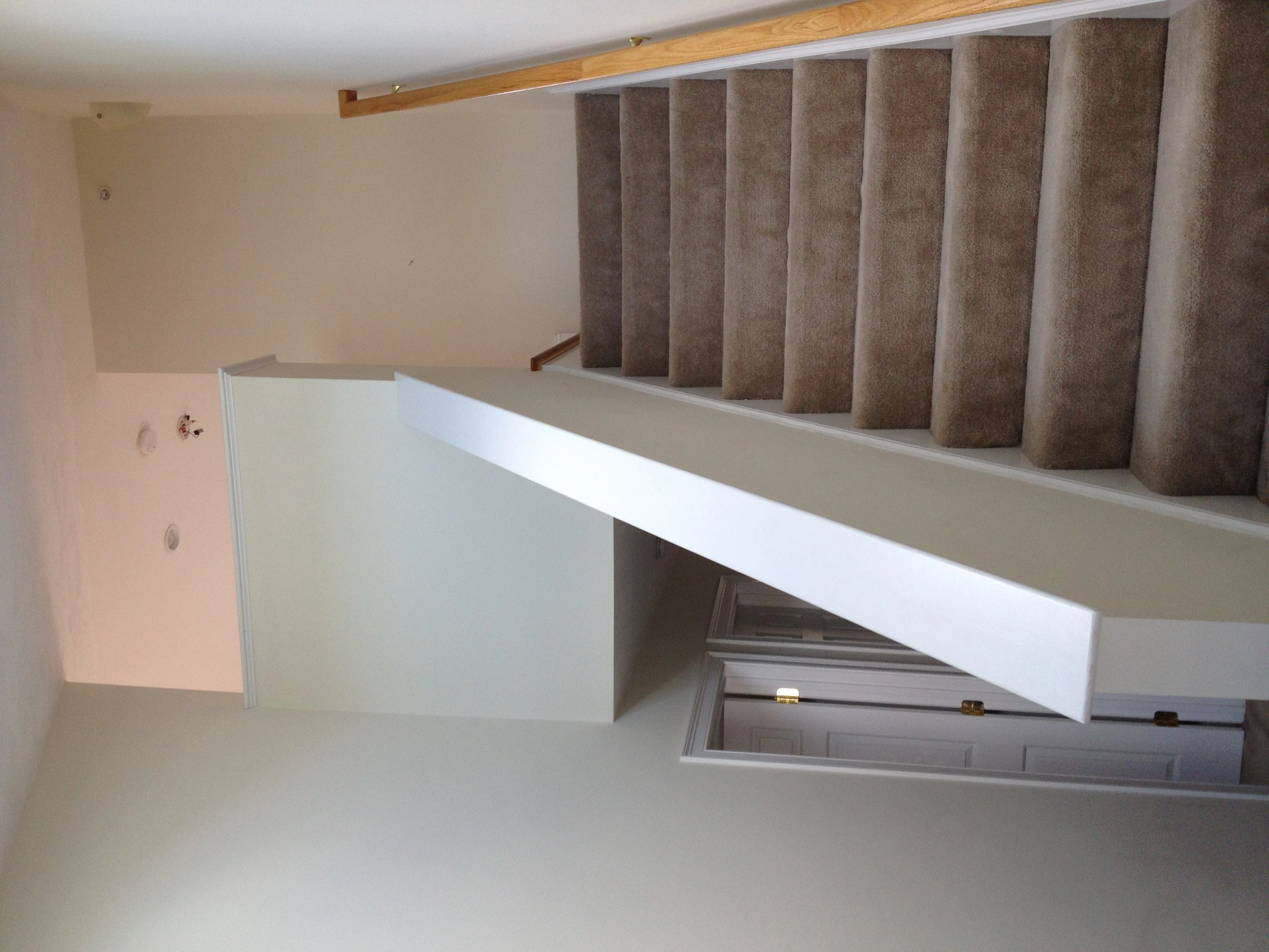

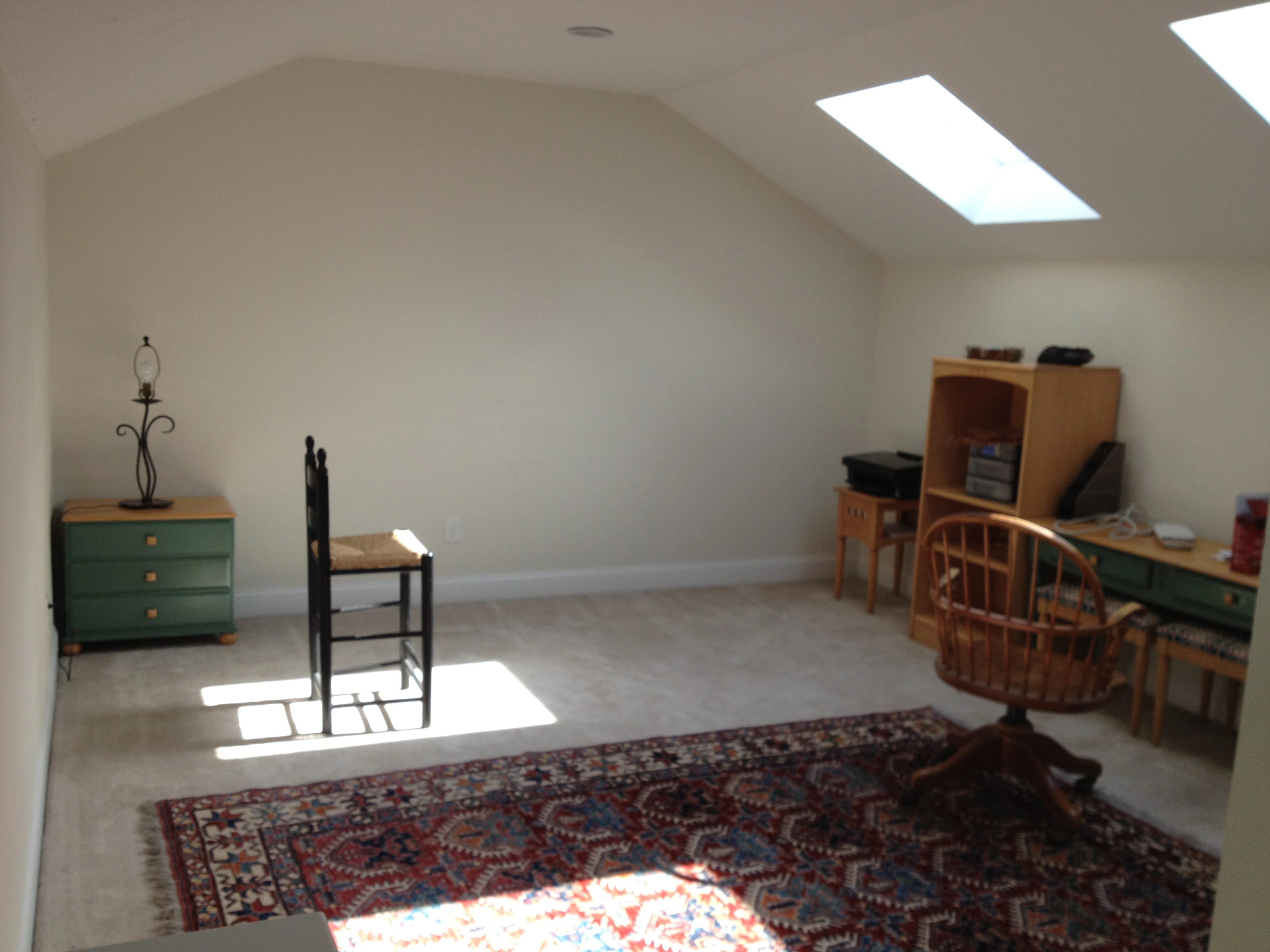

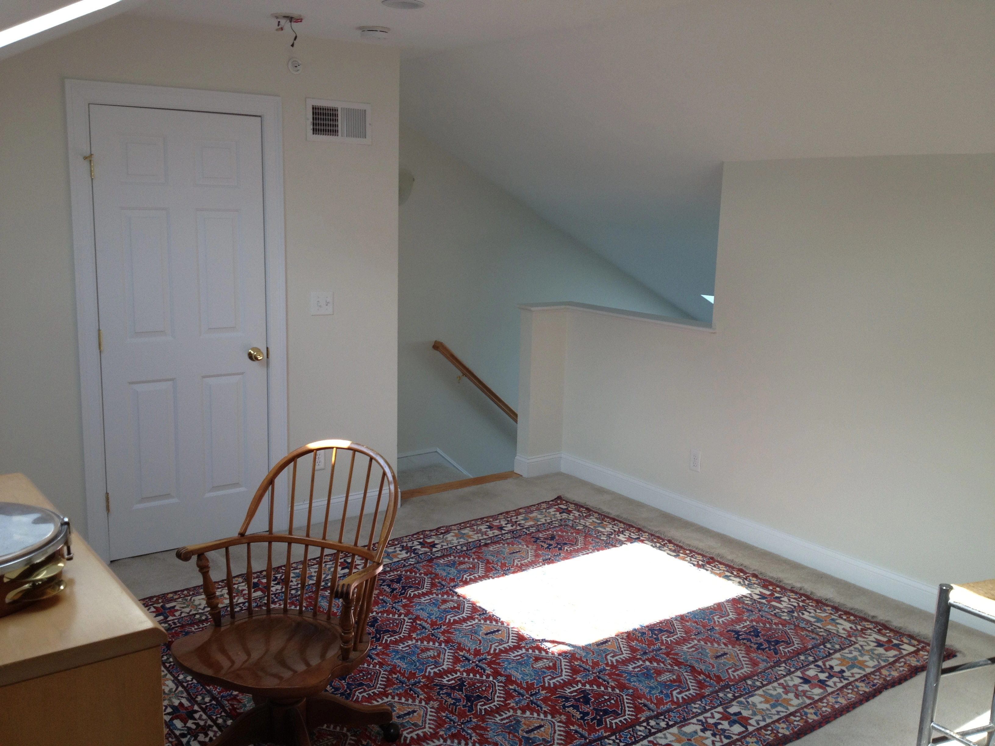

Hey guys. I've got a new room to record in. I've posted some pics of it. It's on the small side, measuring out at roughly 1560 cubic feet. As you'll see, it's a rectangular room with an angled ceiling on two sides. The dimensions come out to: 15.5ft x 13.0ft x (8ft at highest, 5.5ft at lowest).
I'll be recording exclusively vocals, acoustic guitar, random little percussion (tambourine, bongo) and midi keyboard w/hardware synth. I don't have to worry about live room monitoring, since I'll be doing all monitoring through my headphones.
First off:
#1. What's the best location in the room to record in? The corner? Along one of the sides?
#2. How far away from the corner or sides?
#3. Should I face towards the interior, or the exterior?
Second:
Could anyone tell me whether any of the given characteristics of this room are good or bad?:
#1. Carpet
#2. Angled Ceilings on two sides, with skylight windows

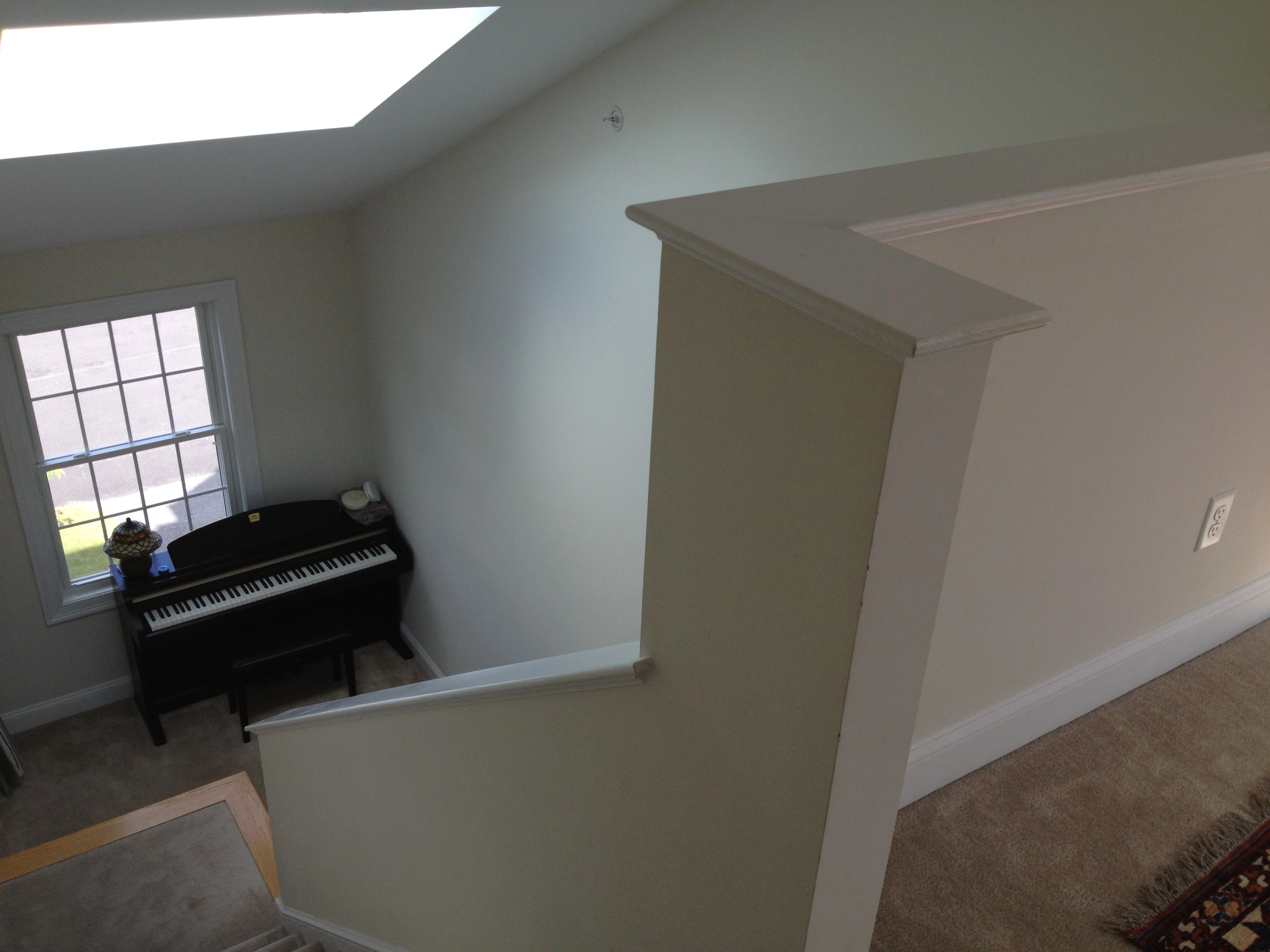

#3. At one corner of the room, there is a staircase that leads down to the second level. As you can see in the photos, the stairwell is entirely open, and looks out onto a 20 foot high landing.
Finally:
Based on all of this, what type of basic treatment should I go after? Bass traps? Acoustic foam? Paneling? Blankets? SE microphone reflection shield?
Okay, that's all! Thanks in advance to anybody who answers my questions! I'm finally about to record a real demo w/ real equipment for once: AKG C414 mic, Focusrite ISA One Preamp, into an Apogee 2 Duet, and finally a Macbook Pro. Since I spent tons of time figuring that recording chain out, I figured I definitely shouldn't ignore the room sound.

Hey!
Bass traps are always useful so if you are handy with tools make them yourself.
The open room could not be a problem since there are cases before when open door can act as a bass trap. However every room is different so no one can tell you exacly how good or bad it is.
For mixing it probably won't be too good without some bass traps, etc, but for recording the instruments you are talking about should be fine. Set up a couple of feet off the end wall facing towards the wall with the door and stairs.
Definitely face towards the downstairs for vocals as mjb mentioned, and it will help get rid of some of the reflections back to the mic.
Also - that open space to the downstairs is a natural bass "trap", or bass "exit", as the case may be.
