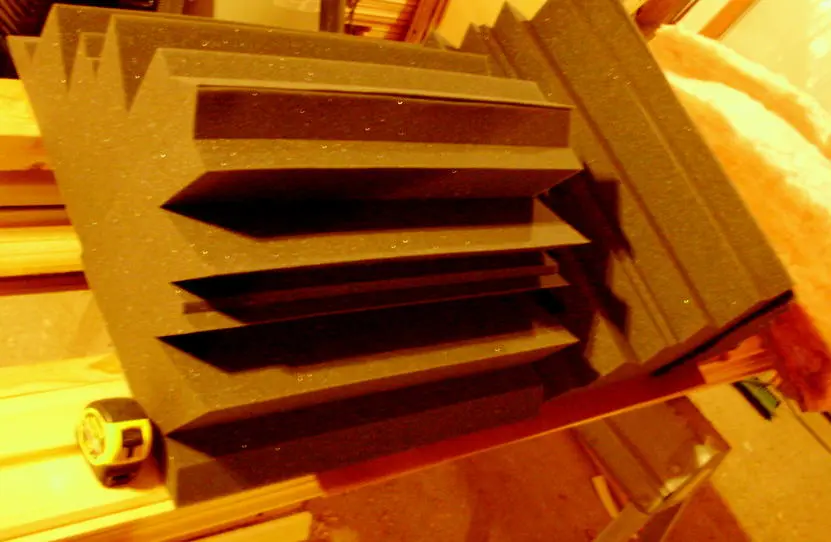

Just so everybody knows, I actually have some foam in my control room...I think I have four LNRDs and two 2'x2'x2" pieces. But I also have fourteen 4" broad band panels, five 6" bass traps, five 2" high frequency panels.

I have a little bit of LENRD foam to install too. ;)

As for that space...that is a really, REALLY though room. Honestly man, I wouldn't put a STITCH of foam in that room. Not only is it tiny, but that slanted ceiling is going to absolutely kill you. That's the thing about small spaces...they actually take MORE bass trapping than a large room to make them useful, not LESS. At a certain point you need so much trapping that you'd fill the room up too much to make it useful.
Given the space as it is, I'd put 4" panels on the front wall placed vertically behind your speakers and at a couple of 4"' panels placed horizontally along the bottom of the back wall. I don't know that corners will even be an option because you'll loose so much space by straddling them. If you can swing it, a couple of 4" panels placed horizontally on the slanted ceiling will help immensely as well.
I know you want to hear recommendations for foam, but I just don't have any. I mean, you can try to stick LNRDs in the wall/wall corners and in the wall/ceiling corners, but they're not going to help much. MEGA LNRDs would work well, but at that price you might as well do panels.
