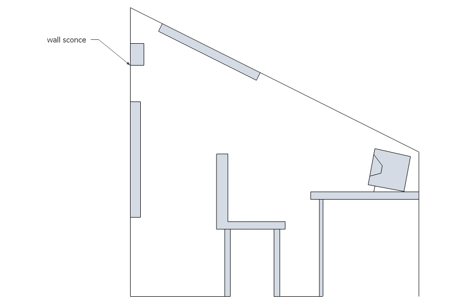

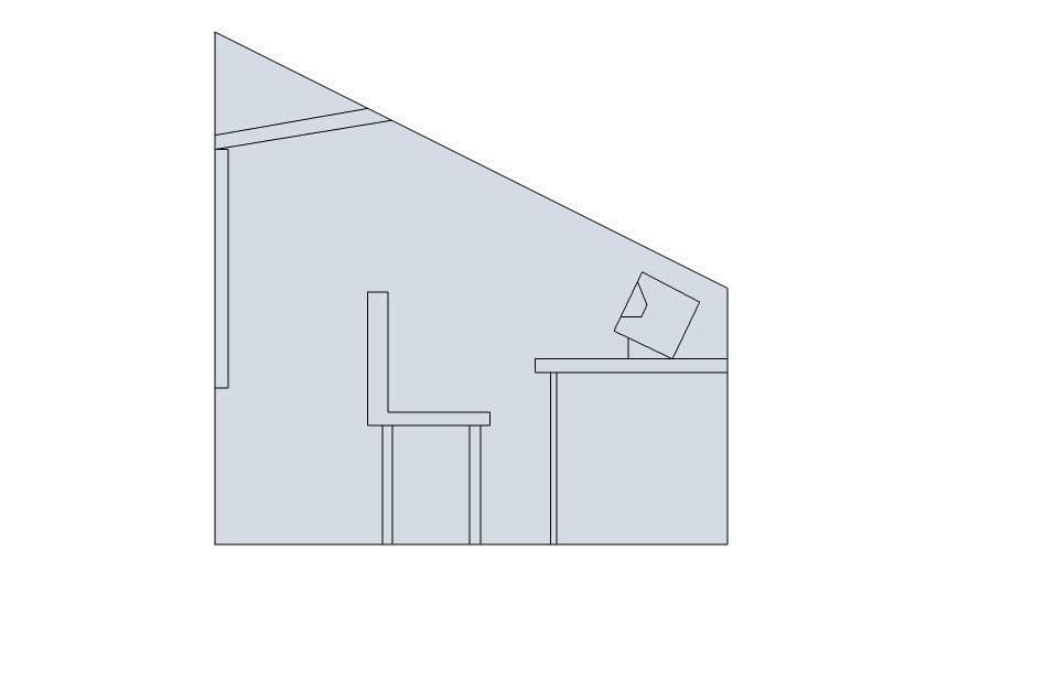

Cool your monitors fit...however you'll want to angle them up toward your ear when you are seated in the mix position. Mopads will help with this.
I would put those 703's behind your chair at head height when you are seated.
Than would be a good start then maybe one up in the acute angle of the room.
I made you a little illistration :) Notice how the monitors are positioned.
Cheers friend,
Scott.

Yikes...I just noticed the wall sconce...might not want to put anything too close to that. ;)
See my revised drawing.
Scott.

Ok cool, Yeah I got the auralex mopads under them now but I just got them straight. I'll angle them upwards. Thanks for the drawing. I'm gonna get on it in a bit once the wife and kid takes off. I gotta dig out the 703 from the basement storage.
