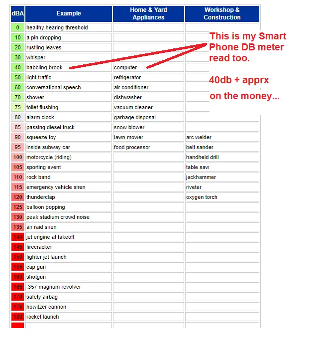

this chart shows my DB meter was right on, with the db spec of the fan 38db, and what I was reading 42-45db.
I noticed a lot of fans are 25-38db. The Silent can get to 10 approx.

Installed "Silent Fan" $6....DB meter is still reading 40+db.
It seems a little quieter but the db meter isn't showing much change.
All three fans going, and the hard drive is clicking away. If I move the mic to the other side, 4ft from pc, I can get 35db.
oh well... down the rabbit hole I go? :rolleyes:
last test for the day....Im getting 33db without the pc on, its as good as it gets without the pc, so now I wonder is 7 or so db worth the cash in this situation?
hmm? think Im done for a few days on this one. thanks for the ideas. I shall ponder them, over some scotch....
