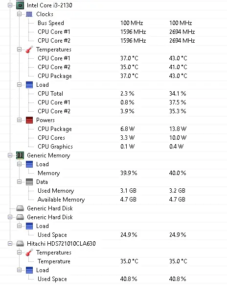

Here - This'll give some meaningful information.
A screenshot on the main page with everything expanded for mainboard + cpu would be ideal.
It opened with some app File Viewer....
heres the picture...pretty wild all this info is kept.
