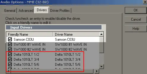

Hi all!
Sorry for dummy question, but I have never touched USB multitrack interfaces. I am looking for USB multitrack recording interface (with 4 or more separate analog inputs) what will appear as separate Wave (MME) Devices in Windows XP/7. Multiple inputs via ASIO/GSIF/etc. will not work for me, because I am using some proprietary software what supports only Wave devices as input sources. I can't use another software, so it's a mandatory requirement. Therefore, I need interface which will give me something like this:
I do have Delta 1010LT (PCI card) and it works exactly as I need. However, times of PCI are gone, and I need something similar with USB.
P.S.
Also I am interesting in Cakewalk UA-1G. It provides just 2 inputs (it's ok for mobile use), but I am not sure that 2 of these inputs will be available as different Wave/MME devices.
Thanks!

Not sure I quite understand your problem WiFi but if I knew the software you were using I might find a demo of it and see if my NI KA6 answers your purpose? It has 4 analogue inputs plus two more via S/PDIF. The latency is better than the Delta cards, I have a two 2496s in this PC.
Dave,
My problem is very simple. Most of multitrack soundcards doesn’t appear as separate Wave/MME devices. They are usually appear as one device, and multichannel I/Os appear only in DAWs.
You can download this software and try: http://www.proscan.org/ProScan_7_8.zip (it's very small). Just install, run in demo mode and go to: Recorder > Input Audio Device. And try to take a screenshot of Input Audio Device pull-down and post it here. It will help. Really appreciate your input!
P.S.
I do not care about latency. It does not matter in case of air transmittion recordings (purpose I using the multitrack soundcard).

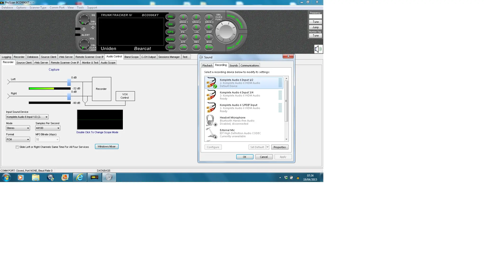

Is the attached of any use?
The level on the top track comes from an AKG P150 stuck in front of telly.
I included the Windows "mixer" seemed moot?
I could not in the 10 mins I have been messing with the program, find any reference to drivers? Tell me how and I shall be happy to look.
Fascinating software. WTF is it for/do? Is it expensive?
N.B. For convenience this was done on an HP i3 laptop running W7 64 bits Home Premium. I can rig a much more powerful Asus MOBO+ 6core AMD if needs be? Same OS.
