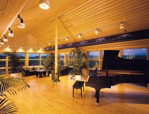

The ideal home studio would look something like this ...

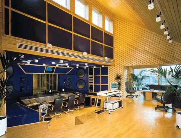

And the mixing console would look something like this ...
That's just like mine except for cleaner and bigger. With better acoustics and real equipment, not just a tiny little box built in my garage with gear and cables everywhere.
Check out the buddage on those weed plants in the pic with the piano...
They must have an understanding with the pigs --- or the place is in Jamaica!
Like I said ... the ideal home studio.

I dunno, Chessrock, I don't think I could move around in that little closet you've pictured.

bennychico11 said:
wow...what studio is that?
That just my mic closet. Wait 'till you check out the CPU room!
:D
