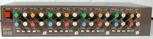

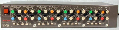

The Tascam PE-40
4-channel/4-band fully parametric EQ, rackmount.
Appx. ~$100-$125/used, on most days.

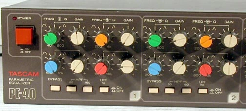

Here's a close detail view of the Tascam PE-40

thanks for the pics, great,
too bad its an unbalanced unit with RCA ins and outs....
and read this:
""The PE40's Q is variable from 1.1 to 5 which, in subjective terms, means that it goes from a broad, subtle curve to a sharp, almost resonant characteristic""
""lower Qs sound more natural -- unless you want to apply cut at a specific frequency, in which case higher Qs are fine.""
oh and here its totally explained:
""In electrical engineering terms, a filter that has a wide bandwidth is said to have a low 'Q', whereas a filter with a narrow bandwidth has a high Q. In other words, the higher the Q, the more selective the filter. A wah-wah pedal is simply a sweep filter with a very high Q. As a rule, lower Qs sound more natural when boosting whereas higher Qs are useful when you're cutting.""
thats the opposite of what i thought it was, here it seems like a Q of 1 is something that affects a wide range of frequencies, and the Q=5 is a notch filter type of eq ?
