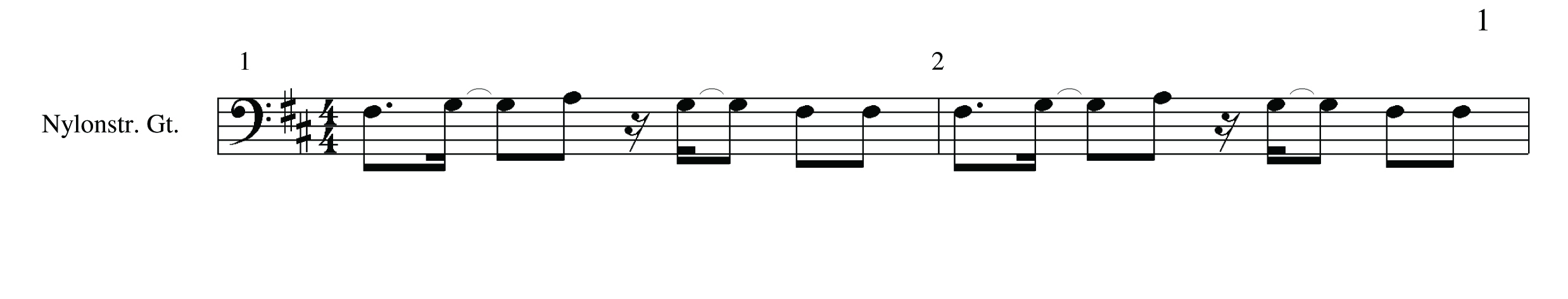

Yeah, it's 4/4 with a triplet feel.
You could maybe claim that it's in something like 5/4 with each of those slow triplet notes being a beat, but that's just needlessly obfuscating it.

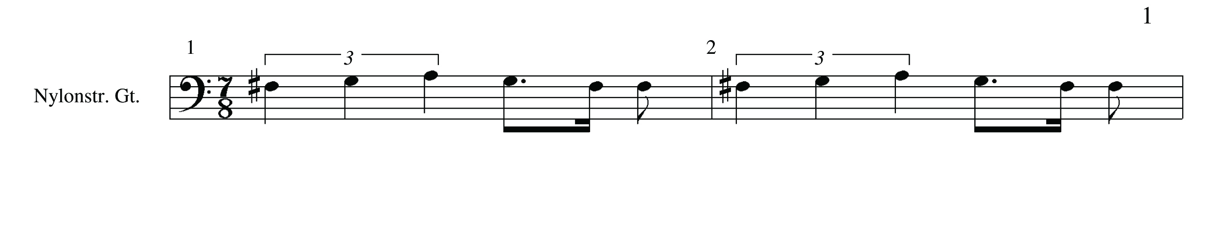

It could be 4/4. But I would prefer to score it as 7/8.
The score looks a bit more sensible in 7/8 rather than 4/4.
However, what is missing is context (e.g. like the rest of the song), and that would give some clues as to how one should view the tempo.
Are you sure that 7/8 time is right? I was trying to conduct the sample and it was rough. What I did to smooth it out was really almost the same as conducting 7/8, I broke it down into 3/4 | 4/4...repeat and rinse. That may be wrong but it did conduct more smoothly.
It's definitely 4/4, not anything else.
Put a metronome on and play that pattern. It will fall perfectly in 4/4.

It can't be anything other than 4/4
There's nothing unique about this pattern. It's been done a hundred times, and they've all been 4/4. A time signature isn't a matter of "opinion". It's either 4/4 or it isn't. This one is.

I can't for the life of me see where Gecko gets 7/8 from. 7/8 is one short of an eight count - it's definitely not doing that!
