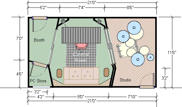

Here is what I did with my ~22ft x 12ft space
It has been working out so far and really no complaints. I of course wish I had more space but I did what I could. The drums are in the studio and the guitar in another room outside of the studio and vocals in the iso booth and the bassist DI to the board in the control room. This room was a John S. plan.
Also I have painted concrete floors with throw rugs.
Maestro do you have any treatment in the drum room? Do you have any sound clips of the drums?
There is no treatment in the room as of yet ; so far the sound has been best described as live. The walls themselves have some acoustic value from what I understand. Two of the walls are 1/2 on rc channels with rigid fiberglass for insulation and mounted to painted concrete block. The other two remaining walls in the drum room are 2 layers of 5/8 drywall , metal studs , insulation , 3 inch airspace , insulation , metal studs , and then 2 layers of 5/8. I don't have any sound clips right now but will work on that. I just finished up the room and have just wanted to play again so I haven't been doing any recording. I just want to say to anyone that is thinking about building a studio to prepare for alot of work. Studio building as I found has to be done right or it's not worth doing. Be prepared to spend about 10 times what you thought it would cost. Figure in my little space I have about 45 sheets of drywall in there , about 20 tubes of caulk. Plan ahead and do it right the first time and if you can't get the funds then wait until you can buy what you need to do it right. Just wanted to add this. This is from John's site.

The booth is about the same size as mine if my math is right. It will still come down to treatment. Be sure to check out all of the pictures ; it is one very nice studio.
