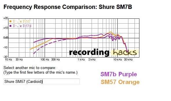

Slightly different frequency response between the the SM7b and SM57. For spoken voice I've found the SM57 just a bit more sibilant and less 'beefy' than the SM7b.
