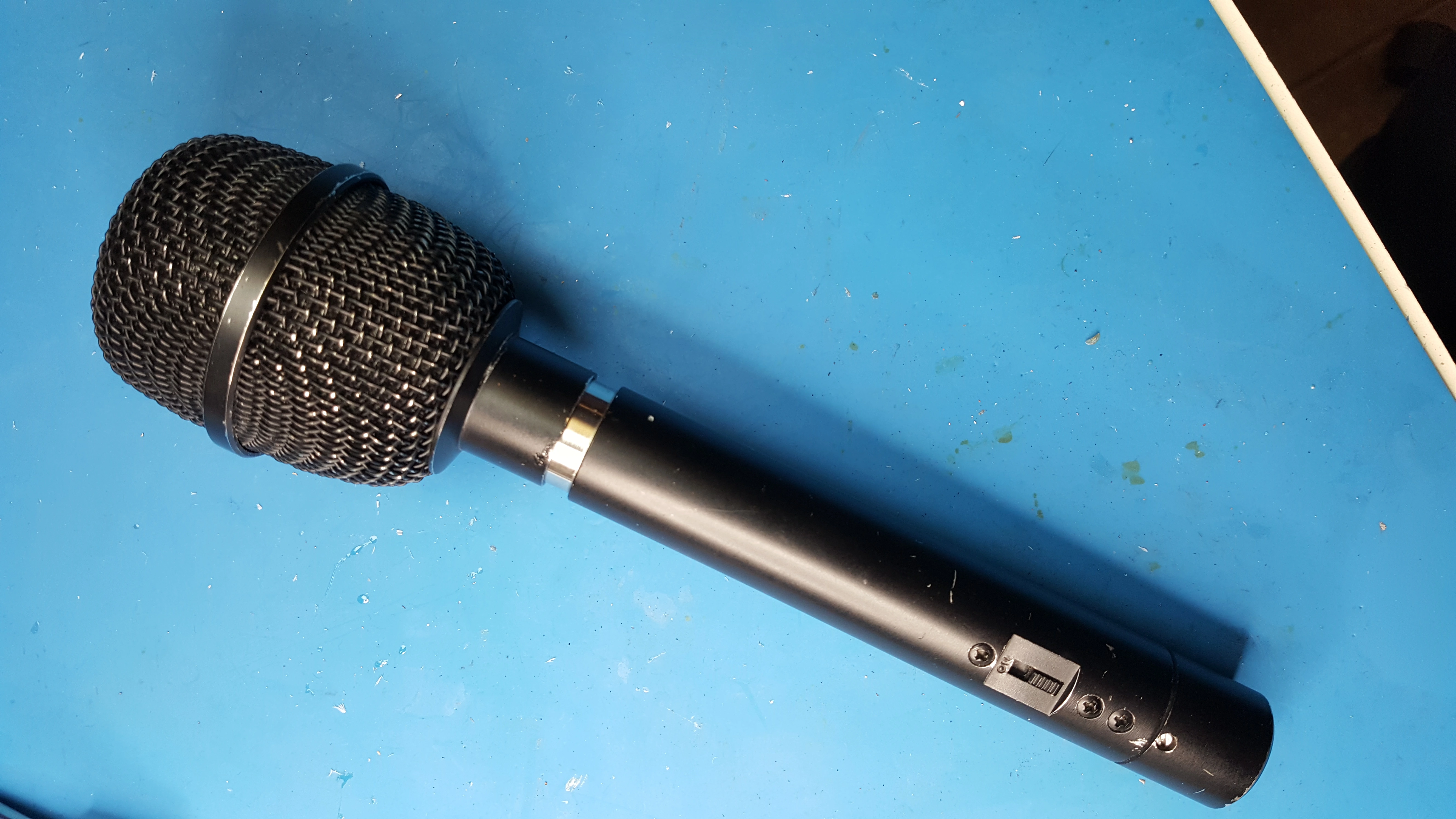

Can anyone identify it from the picture? I've had it for years and it stopped working.

Hi Mark, my amp doesn't have phantom power, so there must be battery power, but I can't see how the battery is accessed. Maybe the battery leaked and glued the thing shut.
I seem to have a memory of changing the battery years ago. I unscrewed every screw and the windscreen end. I know there's a battery in there because I measure about 200mV DC (as from a dead battery) going into the switch circuit board.
Thank you very much,
John
Ahh... Just read the link you provided. Yes, it must be glued shut from a leaky battery. Hope I can salvage this thing. Thanks again.

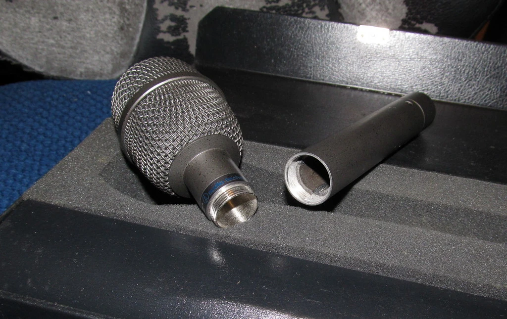

It should unscrew as shown below...

Yep, got it. What a mess inside! The top half of the battery disintegrated and the bottom half is stuck in there. I have some excavation to do! Thanks.
It was tedious... but it's done. SUCCESS!
I'll be sure to check the battery a little more often.
Thanks!
