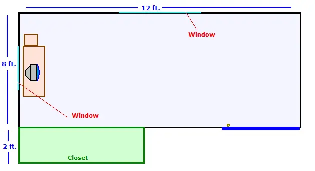

Anyway Here's the clip, and I also attached a small picture of my room as it is.

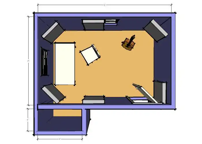

you may need some traps to tail off some high end reflections and some bass traps in each vertical corner. check Ethan Winers site.

gullfo - wow thanks for that!
I'm guessing you made that in Google Sketchup? If you still have the sketchup file, could you possibly zip it up and attach it?
If not, that's completely fine.
Awesome, that diagram really helps. I'm going to try and build six panels as that is exactly how my room looks.

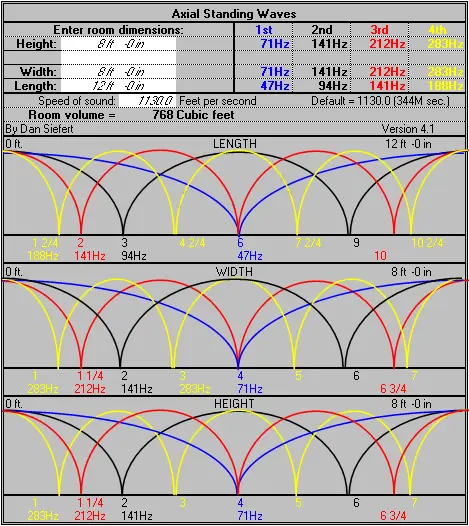

I also tried out the room mode calculator. Here are the results:
Does this mean I have standing (canceled) waves at:
71Hz, 141Hz, 212Hz, 283Hz, etc...?
I'm not really sure what to make of these results... :confused:

Grilled_Cheese said:
PM sent. :)
somewhat... read this: http://www.johnlsayers.com/phpBB2/viewtopic.php?t=2441
explans how to map it to your room and then you can see the areas that are likely to be problematic.
bottom line is all rooms have standing waves resulting in cancellation (lower volume @ freq) and peaks (higher vol @ freq), comb filtering (coloration), resonances (vibrations), and phase (time of arrival @ freq) (different freq = different wave length combined with above = phase issues).
all you can do is try balance these factors based on your desired room "sound", noise levels (inbound and outbound), and permission/budget.
for instance, dead-center on your room is going to be null @ 47hz. if you do a lot of stuff with a low F# on a bass (47hz) you may find yourself bumping this up in the mix. http://www.phy.mtu.edu/~suits/notefreqs.html
but if you sit off center to avoid the 71hz (width) null, then your side-to-side balance will be off. trade offs...
so you probably want to sit 3 1/2' or 5' from the front wall, dead center for balance, and trap 47hz (which is where a couple of www.realtrap.com Mondo Traps might be useful)
moving forward or backwards 6 inches will matter on the side-to-side nulls. the 3rd and 4th level modes are much lower in volume but may constribute to comb filter and phase effects because they're more in your hearing range. etc...
none of this so far is dealing with flutter echos (parallel walls causing short echos), reverberation (causing muddiness, softness), and sound isolation...
