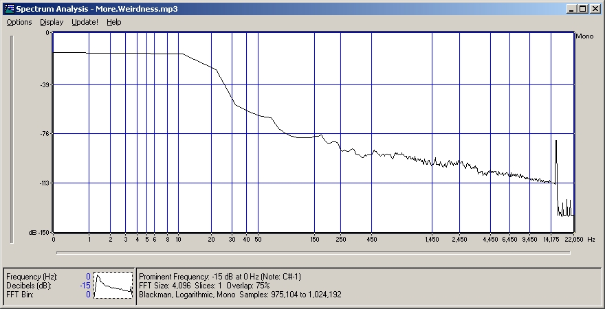

what in god's name is this bizarre wave form?
  • Thread starter Thread starter Unclejohnny
I would have to agree that its from a low frequency outside source-maybe some kind of comunications in the airwaves. The waveform sure looks low frequency-but you would need an O'scope to figure the range.
It's pretty much all below 30Hz.
The part without the interference:
The part with the interference:
I got to the bottom of it! Thank you everybody for your thoughtful help on this.
It was the shock mount! The elastic had slowly deteriorated after years of near daily use plus, the thing you twist to hold it at the angle you want had worn down.
I had compensated by adjusting the boom to a straight up and down position and it finally got to the point that the shock mount basket with no more bounce to it came into contact with the boom. I restrung it with rubber bands and reset the boom in a more typical position. Problem solved!
I'm half a block from the elevated train and sometimes I can feel it shake this hundred year or so old house so it was that and other random things causing the real low frequency vibrations that got in the mic. Bobbsy was on to something when he got a copy of the mp3 that I showed in the screen shot and said it had a lot of low frequency energy in it.(I'm editing now because it wasn't till after I posted this that I saw the further exploration of real low freq as the possible culprit by Boulder Sound Guy, Gecko, and Anfontan and I want to acknowledge you guys, too)
I came home from the music store with a new interface that has a separate power source from the USB because they thought that might be it. I hooked it up, turned it on and sat there watching it record, looking for the freaky wave and then I bumped the mic cable and noticed it made a very similar shape. Then I tapped the mic stand. Same thing! That led to taking a closer look at the shock mount. Returning the new interface tomorrow!
