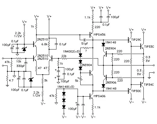

Maybe this will help clear things up-

yep, that cleared it up for me. :D
