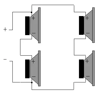

To get the cabinet (all four 8 ohm speakers) to run at 8 ohms you must wire them up exactly like this.
Thanks Raw! The diagram is perfectly understandable, and I had no idea you could get speakers so cheap!

Sure thing.
