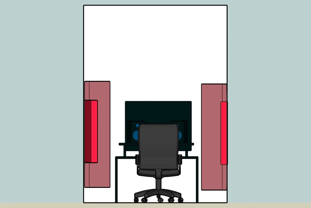

my band have recently moved into an old social club to rehearse. the space is huge and has a small room in one corner which i've turned into a control/ mixing room and we use the main room to rehearse and record live.
i've built some gobos from doors with carpet attached to the sides for some basic separation and hung a couple of clouds over the drums which has made a big difference to the drum sound.
we've recently recorded some new demos, tracking everything live then overdubbing lead guitars and vocals. the recordings sounded really good but when i got the mixes home they were very bass heavy.
i thought this to be weird because there seems to be a lot of bass in the mixing room so i thought, if anything, i would be over compensating for this and the mixes would end up too thin.

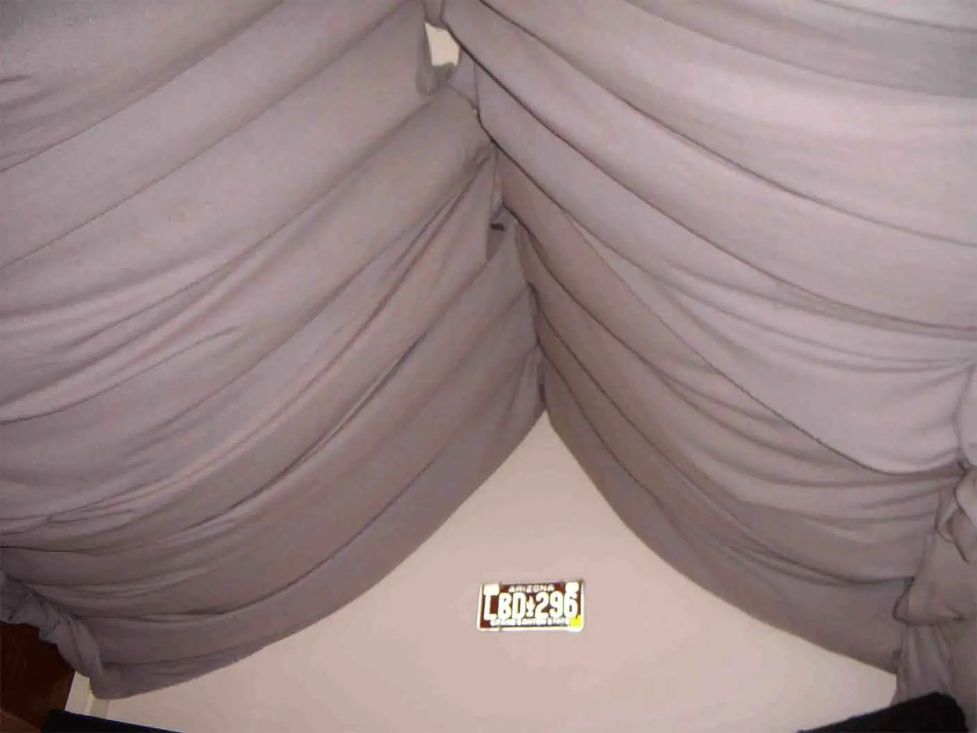

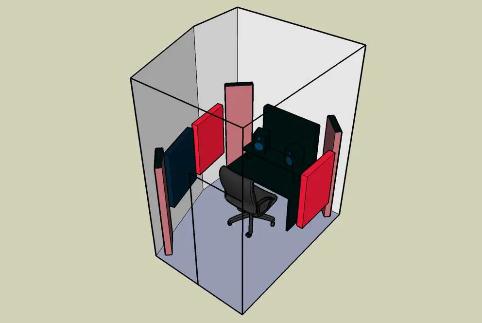

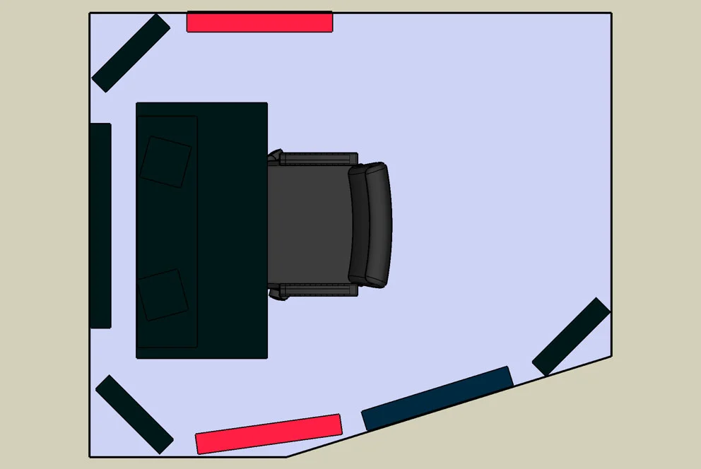

the ceiling in the mixing room is very high so i hung some blanket which took away the echo and then i added some absorbers and bass traps which you can see in the pics. i've noticed that the further away from the monitors you get, the more bass you hear.
can anyone advise me on where i'm going wrong or how i should improve the sound in the mixing room
thanks

It's pretty common to have holes and hot spots.
Take the difference between the sound in the c/r vs out side (home, wherever) and compensate. You can also make the most of the variation within the room position to get different views on the relative bass levels.

How have you made your bass traps? How thick are they? I don't like the sound of those gobos(doors covered in carpet).
Maybe the room increases volume at some of the frequencies, but then reduces others. So you mix and get rid of some of the bass frequencies, but add some others. So when you take it elsewhere, it's these others that you hear. And maybe the other place(s) even increase volume at these frequencies.
The room also looks a bit lopsided, with one half covered in treatment, but the other with barely any. Maybe that's needed for that angled wall though. How's the stereo imaging?

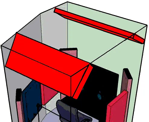

The bass traps you've drawn look about half the width of the other panels. You'd probably be best with 2' wide panels. Also, you could add more traps, like this:

I have a couple thoughts. The reason I asked about the monitors is I wanted to see the porting config.
For one I would try messing with the speaker location. it looks like they are pretty tight in. From the picture you don't have alot of room to work with but, you may try moving the desk away from the wall some and see what that does for you. You can spread the speakers further apart to make the distance to you further with out taking up much space, if you have room.

Also, in tight spaces like that, boundary reinforcement issues become huge (SBIR). YOu need to make sure you have at least 2" material directly behind and directly beside the monitors on the hard surfaces - not just at the reflection points.
Bryan
Bryan
Think he does brian, by the looks of the pics...
Oops - missed the top view. Looks like you've got that covered. Have you tried anything on the rear wall of the room directly behind the mix position?
