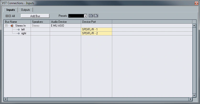

I have a stereo interface going through an SPDIF port. So my connections look like this:
For the Inputs, I only connect a stereo bus. If I need a Mono track, I just select Mono when creating the track then Right or Left channel of the stereo bus in the pulldown menu. It's pretty straightforward.

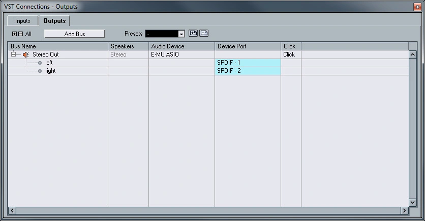

Here are the outputs. Be sure to click in the Click box so you can hear the metronome. Aye, you don't know how long it took me to figure that one out. :confused:

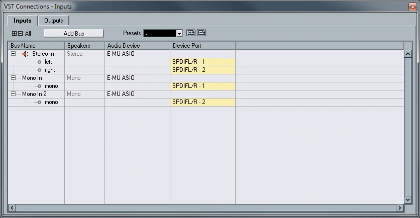

No, that wouldn't be true. The ASIO driver doesn't determine if a channel is stereo or mono. It really comes down to if you want to make the connection Mono or Stereo.
Here I created two nwe Mono connections using the same channels as the one stereo connection. Doesn't matter to teh ASIO driver.

My EMU mixer dictates all ASIO connections are in pairs... you can always simply set up one side of the pair in a Cubase connection though (As it appears you are doing).

In Chili's pictures of the VST Connections panel, you can click on the "Device port" (the bits highlighted in yellow on his pic) and you should get a list of available connections.
Once you have set up the connections in Cubase you then need to tell your individual tracks which connection to use.
