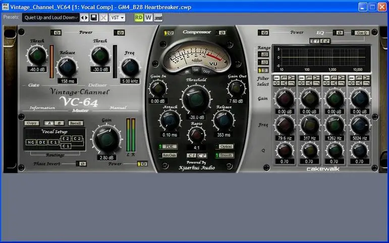

True - I'll tell you what I use and the settings but it's very likely you don't have the same software.

ido1957,
Very nice plugin. I use the same one on vocals when needed.
