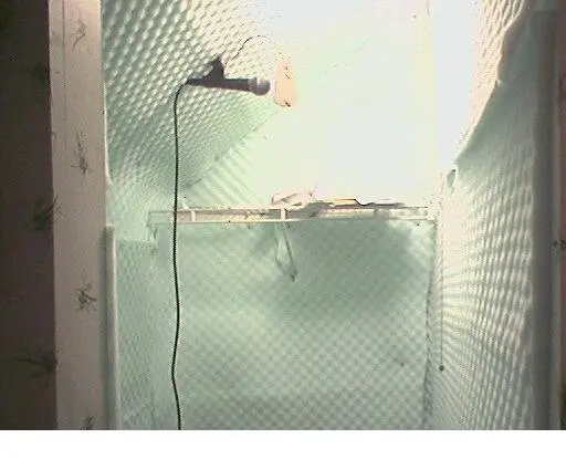

Now im positive the mistake is coming from my lack of knowledge in the mixing area because a friend wit tha same setup n computer half as good as mines turns out an almost flawless project. Now I do hiphop music, like i said my quality now is decent but Im sure it could be alot better.. Ive tried to find a how to on mixing n thingz of that nature, but ta no avail have turned up empty handed.. Im getting to what my knowledge is a good signal from tha mic , tha little room in which i record my vocals is not fully sound proofed but does a well job so I do not think it has to do with that. I will upload a picture of mic placement so you can see for yourself.. I am sure that it has to do with my mixing skillz in general. Now I use cool edit pro to mix n process all of my audio mixes.. Can anyone help me..
ok now heres a sample of me rappin that i put together..
http://www.soundclick.com/util/stre...?ID=628590&q=Hi
the mic in the pic is not being used, i now use a rode nt1.. lol and i have a shure pop sheild not the bootleg panty hose one lmao..

Do you mount the NT1 on a stand???? or hang it like in the pic.???
BTW.....I think that link is broken.
If you don't have/use a stand for the mic, I would get one because it will give you more mic positioning options.

its the latest one that I have recorded using the equipment I have. Yes the Rode nt1 is mounted on the wall like the shure sm58 is in the picture, should I get a stand still..? A pre amp would probably suit me considering I paid 69.99 for this 2 track mixer.. Anything else..?

RE: your sound booth.
Your sound booth is all foam and is no bigger than a phone booth. There are no good accoustic properties other than there is little outside noise. Try taking your condensor mic out of the booth and put it in a room with some space. put the vocalist a 3-4 feet out from the corner with their back to the corner so they are singing out to the center of the room. You will get a more live sound because the sound waves have room to move. Yes you will get environmental noise, especially using a condenser mic. However the quality of the mic is offset by using a soundblaster card. Anyway, even if you need to run a noise gate to cut out the "noise" I think you will get a much more natural recording.
I think your sound booth would work great for narration but not singing.
