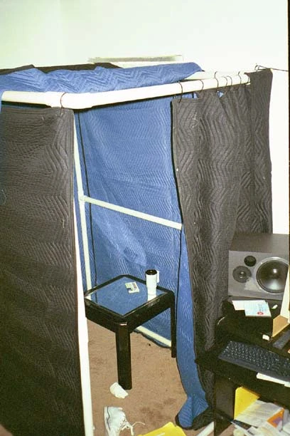

Booth with the "door" open and top down. The blankets slide open easily with the twine rings. I don't really call it a booth, I prefer to call it my fort.

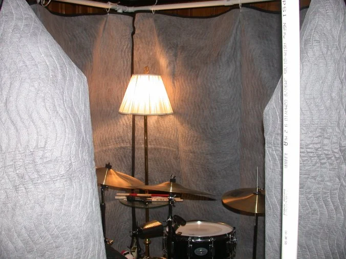

As you can see I made it large enough to fit my lame "drum set."
I recorded some acoustic guitar in there a couple weeks back and had plenty of room even w/ the drums in there. Didn't sound too bad either.. Less funky reverb, but in no way completely dry. The more blankets I throw up the more dead it gets..
Now I just need to find the time to finish and play in my fort..

Mine looks alot like yours. I used those nylon cable ties to hold the blankets up and just tucked them in at the bottom. for the door i left the cable ties with enough slack to slide back and forth like a shower curtain. did u glue yours, or just jam the pipe to the fittings really good?.. pics coming soon too
thanks homeuser
went to Lowes (like a Home Depot store) and told the guy there I wanted to make a booth out of pvc piping. He recommended 3/4 size. I told him 4 legs, and a square at the top and bottom. Total cost for 7ft high, by 3 1/2ft wide booth was about $25.00. I put it together in less than 5 minutes. Actually I trimmed so it was a little smaller

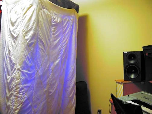

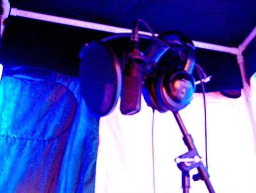

i read this post and the very next day went out and done the same exact thing. it did take under 10 minutes to assemble. i had these 3 king size comforters that i used to enclose the frame. i went to walmart and got some jumbo safety pens. i draped one comforter over the top then to another and penned it like and L, or right angle, then i penned the other on the opositte side the same way. i didn't feel any need to have any buttons or velcro to close it because the large comforters were big enough to over lap. i just let them hang and they close good enough on there own. to make it sweet, i hung a long black light from the pvc, it sets it off. the black illuminates the white paper with my raps so i can see, plus i don't have to worry about that light bulb getting it hot as hell in there or catching something on fire. the black light brings me that club energy. but if you want it to really look good, use white comforters, i have one on mine and it looks tight when the black light is on.
my vocals sound a lot better because i'm not getting any reflections from being in the closet. the closet was treated with blankets, which absorbed the high frequency, but the lows were still reflected. i took the mic out of the closet after seeing cross's set up. my room was too live so i was actually hearing the slightly but, annoying highend reflections. this vocal booth sounds the best out of the two hook ups and it only costs 30 bucks for the pipe and joints. be sure to get the right joints to assymble it. the booth freed my closet back up for my cloth, and now i don't have to worry about being cramped up.

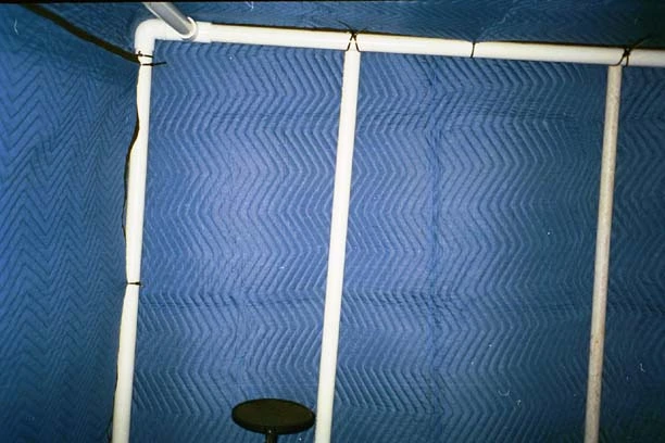

I recommend the pipe u use to be 1 1/4 inch sch40(stronger grade)
if u want to glue it to make it stronger,first:
1. loosely piece it together to make sure that your design works.
2.mark and label every point where piece of pipe and fitting join. [i.e. pipe end A and fitting A line up exactly HERE] Glue sets relatively fast and if u dont have it set right u may end up trashing some material
the sliding door

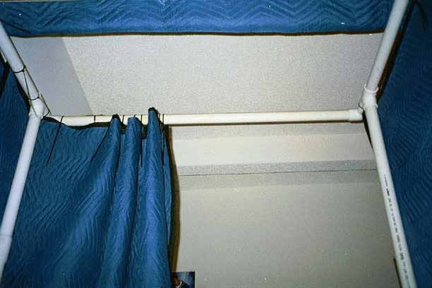

This is the ceiling. I had some extra pipe I scrapped them across the top and threw an extra blanket across for the ceiling The thing is it gets really stuffy so i flipped one end of the blanket back

Pipe across the top is a very good idea. Since my fort is so big, the blankets sag in the middle using the twine to support the ceiling. Alas, I'm short enough that it doesnt bother me... but I just might get some extra pipe to make it sturdier.

Anyone tried this on a larger scale? (eg for recording drums)
yo
look up at trickless's picks. further at the top of this page. he has his set up for drums.
