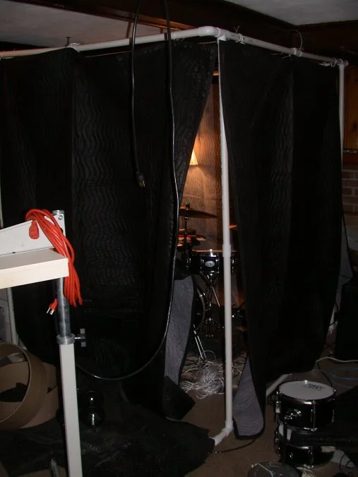

crappy pictures..
This is the booth slightly open from the front.

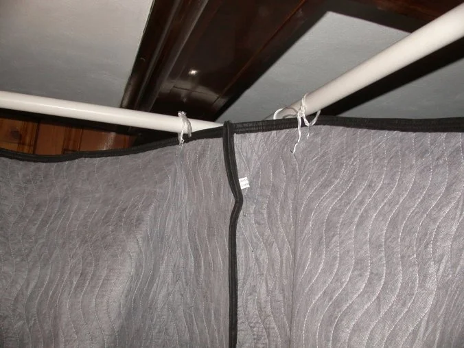

This is my new method of attaching the blankets. Still using the saftey pins, but now they are attached to a twine "curtain ring."
I am currently using 3 mounts per blanket, but am going to use 4. Also I need to pin the rings a little lower on the blanket to eliminate the gap.
Three corners are pinned together at the top, middle, and bottom with one open for entry. Maybe I'll use the velcro so I can close the "door."
Also notice the stupid fake beam in the ceiling...
