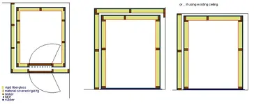

This is how i think it should be done. Get it checked before you build though, by Fitz, etc. And get you existing floor checked to see if it'll hold the weight.

Hey pandamonk, I think there are a few things to consider here. The criteria was...
1.
so i only need to construct the 2 walls.
I see nothing about a "floor and or ceiling". This implies that he wants to use the existing floor and ceiling as part of the vocal booth. Therefore, I see NO need to build double walls if he can hear footsteps above. ;)
2
i want it so you can hear no noise inside the booth, and no noise outside the booth...
This appears to contradict the previous critera. :)
1. so i only need to construct the 2 walls.
2 i want it so you can hear no noise inside the booth, and no noise outside the booth...

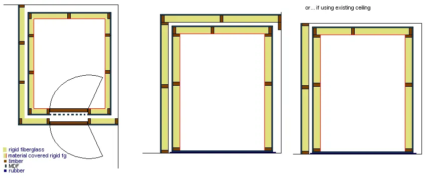

I realise this, i was just responding with what i'd do. But yeah, it does seem to contradict. Anyway, would it be possible to build my suggestion with $500? I'd think so, but I don't really know.
Hmmm, 6 walls requireing framing, insulation, 2 layers of drywall and a door/jamb/latch.. a light and some kind of ventilation....well,.maybe, depends on how good of a shopper and planner you are. :D

Would my booth suggestion need 2 layers of MDF? Would it be better to build with MDF or drywall? For vents, what about two extractor fans, 1 in, 1out, as long as they're quiet... Would that be enough for my small studio? I don't need them to cool at all, just to provide "clean" air.
To me, the only reason to use MDF is if the vocal booth needs to be taken apart later..i.e. knockdown. Drywall joinery doesn't allow for this ...ie..taping/texturing. With MDF modules you could concievably use gasketed joints. Although some people use a layer of MDF in between layers of drywall to aid in hanging things, although I don't see a need for it in a booth. Either build it permanent or knock down. That determines the material in my opinion. One important aspect is cost. MDF is WAY more expensive than drywall, AND requires precision cutting and assembly..which translates into tools/skillls.
