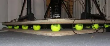

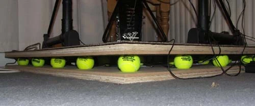

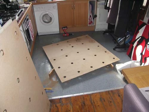

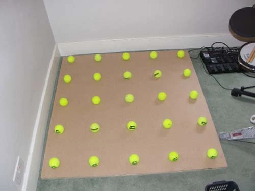

If anyone is interested or cares about noise with their v-drums for whatever reason (apt. living or other members in their home),this is what lots of guys are doing to dampen the impact vibrations from the thumping. Here's how to get started.
I bought 2 sheets of 4'x4' , 1/2" MDF and 2 sheet of 1/2" plywood 4'x4' also. At the same time I bought a kit with four hole saw drill bits, different sizes so I can see how deep the tennis balls sit in the holes. They can't be too big or the balls will roll around beneath in the sandwich.
Cost of wood and screw bit kit-$100 CDN at HomeDepot
Tomorrow, all I need to buy is a piece of carpet 4'x4', 25 tennis balls and some 3/4" particle board screws. I already have this double sided tape for the carpet, it's meant for outdoors so it will last a long time.
I will take pictures of my final product for show and tell. I must build in my old man's drive-way as I live in an apartment or I would be building it right now!
