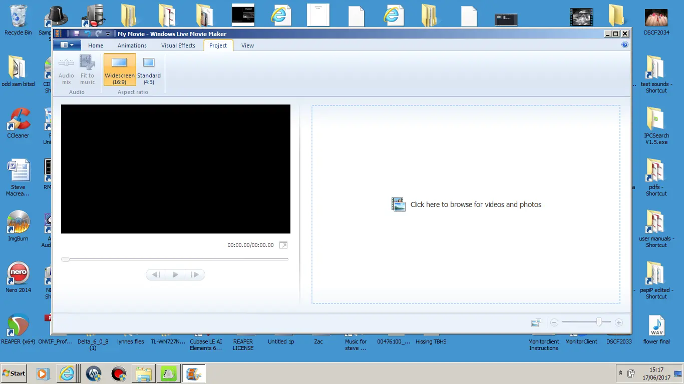

Aha! It seems Msoft want to sell you another app' to allow the addition of another sound source!
'Add Audio' would seem to be what is wanted but is greyed out.
I suggest you download the demo of Camtasia, That allows the connection of any capture device and any audio. When you have run the free time gamut of C, go onto 30 days with Sony Vegas. A couple more demos will get you by until Christmas when 'significant other buys you a new laptop and you can start all over again!

"Did you first add some sort of visual element (photo or video) to your project? A movie can't just be music so Movie Maker requires you to add the photos or video first. After that, you should be able to use the 'Add Music' button and then pick your .wma, .wav or .mp3 files easily.
If you want just a single photo, be sure to extend its duration to the length of the music. You can do this by clicking 'Fit to Music' on the Project tab."
That ^ is an answer from another forum and it seems MMaker is dumb, it cannot allow music to be added from another source in real time (as you can in Camtasia e.g.) You CAN it seems add (replace?) an audio track from an existing video file.

I seems MMaker is not going to work.
