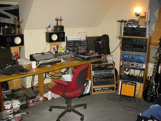

This thread needs pics, so here ya go!
Pic 1 - Wide shot of my studio. Practically all the gear (including everything but the mic inputs on the Mackie) you see is hooked up to the patchbays behind the turntable.

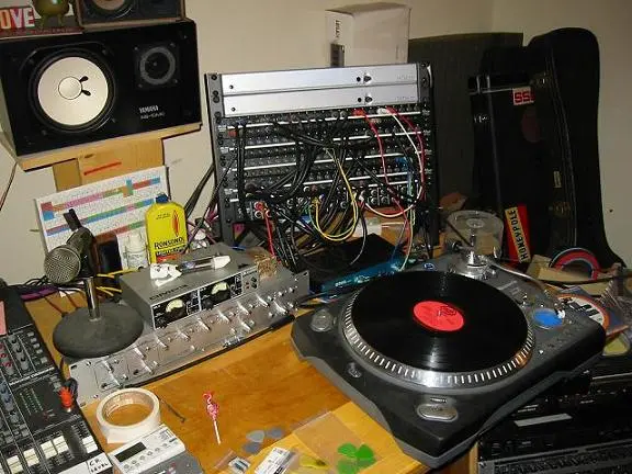

Pic 2 - Closer up. I even made a chart showing all the patch points (under the NS-10).
Whats the cup plugged into??

SouthSIDE Glen said:
P.S. Mad, what I want to know is what's on the turntable? :) . It looks like it might be something from Mercury Records. Am I even close?
I'll give you a hint - look at Pic 1 on the lower right hand side.
D'OH! Nothing like having the answer staring me straight in the face and still missing it :eek: .
