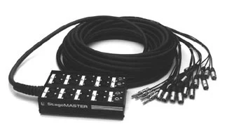

Yeah, they're called snakes. You can get them at any decent pro audio shop or any mail order place. they are available from 50 to 100 feet long, with anywhere from 8 to 24 XLR mic lines, and with 1/4" send and return lines. Typical would be 8 XLR, 2 or 4 1/4" send/returns, up to 24 XLR/4 or 8 sends.
Sounds like a 50 footer might be just right for your needs. This one (attached pix) is from samash.com - 8 x 4, $173 - snakes aren't cheap, but you could use it live also or sell it if you changed your mind... Steve

thanks for the responses. I knew what a snake was I just didnt know you could get them with both xlr and 1/4". I wonder if they make smaller one's than that. I'll have to look around.
one more thing....If I decided to run the cable for permanent use, could the cable detach from the box on a snake? I'm trying to keep the hole small, but if I even just run all the xlr's through it then I will need a larger hole.
Depends on how well you can solder, and what your patience level is... Generally, a snake with a breakout box (normally only on one end, the other end fans out to connect to the board) has the connections hard soldered to the panel mount connectors in the box, then some sort of strain relief arrangement where the cable goes thru the box wall. I've not seen shorter than 50 foot or smaller than 8 mics on a snake with the breakout, but I guess if you were desperate you could make one - you'd need to go to a different kind of place for multi-conductor audio wire - maybe here -

if you get an 8 ch snake, you are going to have to make a hole at least an inch in diameter. this would give you enough space to run the xlr male ends through one at a time til all 8 are through. then you can pull the cable as a whole. (no pun intended)
Yeah, no big deal there - if it's your own place, holes in walls are negotiable between you and the boss. If you cut a hole big enough for XLR's, just be sure to caulk around it once it's in place, with flexible caulk, either silicone (get the 50-year stuff, they lie) or Butyl if it's available. That would be easier than soldering all those wires, and not that much difference in the size of the hole... Steve
