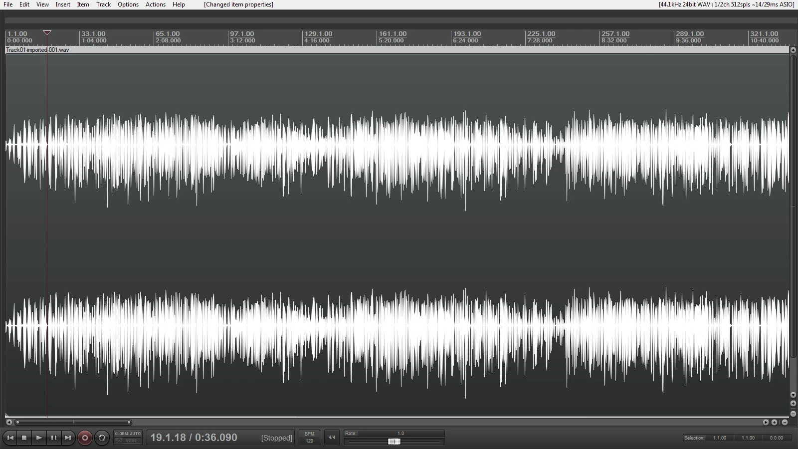

Why are waveforms uneven (from top to bottom)? This is spoken word. A countryman mic -> mixer -> 2 aux sends (L & R) -> CD recorder.
Only the spoken word is uneven. The music that was recorded has even waveforms.
And btw, it sounds fine. I'm just wondering what's going on.
Thanks,
Dwayne
Don't worry about how it "looks", just how it sounds.
Some voices and, indeed, some instruments, simply have non symmetrical waveforms with more energy in the negative-going direction or vice versa. It's nothing to worry about and quite normal.
However, on the other hand, if you see a waveform where the "centre line" is displaced upwards despite the waves being symmetrical around it, that generally means you have some DC offset. This is caused by a small amount of DC electrical current present on the signal along with the alternating current sound information. Most DAWs have a function to correct for DC offset and it's worth running this if only to make amplitude changes in you mix more effective--with DC offset present, you maximum level is governed by the higher side of the waveform.

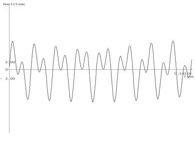

I think your problem is more frequency related. This can happen when additional frequencies that are not harmonically related become part of your recording. (Let us say 1000Hz and 3763Hz, for example) Perhaps some noise such as the wine of a computer fan or a running air conditioner has been picked up by the mic. Or maybe your hardware is adding noise to the signal. I don't know. I am guessing.
The waveform below shows how unrelated frequencies interact, or should I say, don't interact. (Image stolen from the Internet) The peaks below the centerline represent the fundamental frequency and the peaks above the line represent some higher frequency. It is also possible that the lower the affected frequencies, the more obvious the lop-sidedness appears.

Exactly what I said, Raw Depth! Your graphic illustrates it nicely though.
I'd take issue with one thing in your post: calling it a problem. The harmonics and their phase relationship with the fundamental are simply a natural part of sound, not a problem to worry about. Indeed, as I said, I've seen it argued that some of the richest, nicest sounds have very non-symmetrical waveforms because the "richness" is lots of harmonics.

You are correct. I shouldn't have called it a problem, (unless there is audible noise in the track.) Many times I have had lopsided waveforms and left them alone because they sounded fine. As with all things in nature, being different is not a bad thing. Thanks again Bobbsy.
