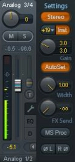

I wanted to know how the mono channels were being sent to the input side of the FX plugins in logic. But I figured it out. The Mono tracks will send left and right signals as long as the pan at the top of that track is centered. But if you change the input track to stereo, you will only hear one side in the headphones if you have a single mic in one-input in that stereo track. This makes me think that the stereo option is only for when you're using two inputs. Notice in the image, that that stereo button is active and the signal is coming in on the left only - even though the pan is centered. But the outputs in logic merge the signal. So if the track is set to stereo, then there's a chance that the FX plugs are only getting signal on one side if there is only one input source.
This does not seem to be the case when the track is set to mono and your pan is @ center.

If you set the input to stereo, it assigns one of the pair to the left side and one to the right side, in you image whatever is plugged into 3 would be sent 100% to the left and 4 would go 100% to the right, so if you've only got one real input and define the track as having 2, it should not be surprising that it only is heard on one side. Maybe I'm missing something.
How your FX act in Logic Pro will depend on how you set the FX, i.e., is it a mono or stereo plugin and how you've set the Pan control to work in Logic Pro (stereo/balance/binaural). Or, if you're using sends, then it will depend on whether you've set them to post or pre-pan. What I don't understand is why you're using TotalMix for setting inputs and using pan, i.e., what are you trying to achieve that you can't do just in Logic?
I'm really not. I was just trying to understand how the different settings in TotalMix effect logic's routing.
You really can't avoid TotalMix, it's how everything is routed in the FireFace. Most of the time, I'm using bus sends and loading stereo plugs in an Aux channel in logic.
I have it down now. Thanks Keith
