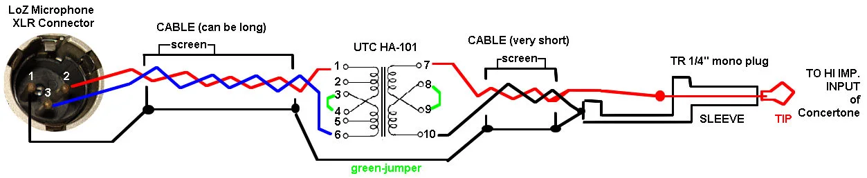

See the diagram attached. While there you also can try different inmpedance option on primary side as per #6 in pdf, (if you feel like experimenting :) ).
Turn the level pot down first when trying this, then turn up slowly.
So if you find this to be a "sexy" input configuration, then you can actually install HA-101 into Concertone and add XLR mic input. Also you'll have to deal a bit with how to place the transformer the best way and connect it and screen/ground all the connecting leads correctly etc. You know how it is there...heh heh , if don't pay attention you get a "mystery buzz" or something :p :D
Generally speaking, as I understand, if you do this, you pretty much get what you already have when using your adaptor. But hey, you never know. Maybe you get some "meat" there.

Mike, Thanks for the diagram!
What about the terminal input screws in back? Can't I use those instead of the high z input? I don't think I've tried this. (but I'm not sure)
Also I don't understand "the green jumper" Isn't the screen connected to 3&4, 8&10, respectively? Or that's is what you mean, indicating green jumpers on UTC in diagram?
This could be good if I'm using the phantom power box.
Steve, "green-jumpers" have nothing to do with cables screens ...I just 'placed' that note there under the black connector "wire" that connects screens of the cables. The green jumpers are just the connections between pins of the transformer as shown.
Pin "1" of XLR connected to the screen of the mic cable and to the screen of the short cable from transformer secondary to 1/4" plug, and connected to the sleeve of the plug as well. I've made this diagram specifically as for your situation.
I am not sure what would happen if you connect secondary of the HA-101 with "Line Input Bridging" terminals, but you can try it too, it would not hurt. If you do that, than instead of 1/4" plug, simply use very short wires and connect: "7" to left terminal and "10" to right terminal. Do not connect anything to C.T. terminal. For that you don't really need a screened cable, just make the wires very short , 2inch or so, so the transformer is sitting right next to the bridging input. It should be fine for the experiment.
Also the screen of the mic cable, then should be connected to the Concertone's chassis - ground, that is.
