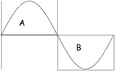

As for understanding, well...
If you look at the attached image, you will see one cycle of a sine wave. The actual signal we deal with is much more complex, but a sine wave is a lot easier to understand, and is good enough. There are two types of amplifier which is commonly used for guitars - type A and type AB. There are a LOT more types of amplification out there, but for guitars, those are the most common.
In a type A amplifier, the entire signal is amplified by a tube. In a type B amplifier the two parts of the signal (part A and B) are amplified by separate sections of the amplifier - i.e., separate tubes or transistors. A type AB is essentially a type B amplifier, but each section amplifies a portion of the other sections signal. Type AB amp are more efficient, and there is a difference in sound between type A and AB amps. Most high gain amps are AB, and traditionally only student amps are type A (because it is cheaper and requires fewer parts). However, there are a lot of very high end amps being made type A these days. (By the way, people have always thought of the Vox AC30 as a type A amp - it isn't, it is a type AB, but it's crossover point is much wider than most AB amps).
My recollection of the sound you're after, you are probably after an AB amp. Still, I'd rather have the one you are looking at than any modeling amp, personally.

i didnt see any attached image... and your right, it cant be any worse than my crappy solid state half stack. Musician's friend is having a sale on it now and its only 100$ so i figure if nothing else it will give me a nice little practice amp.
Whoops - fixed!
