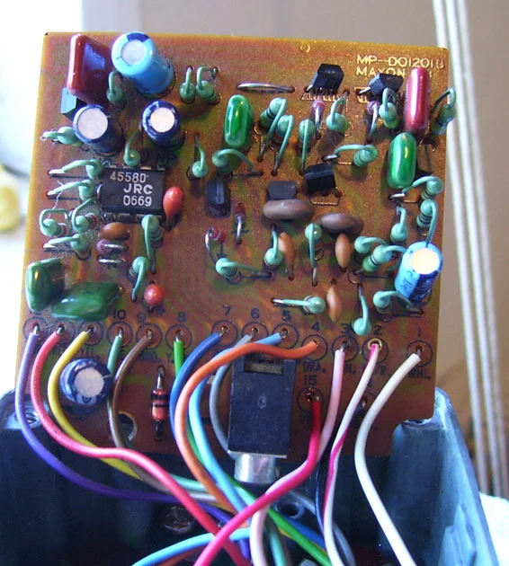

I really don't get the point-to-point fad. You want to cram all this;
vintage808boardNEW.webp​
..... into a pedal without the benefit of a circuit board to hold parts, avoid shorting leads, and be compact? :confused:
The 'best' kit may be the General Guitar Gadget, but BYOC has a BD2 clone that can be modified to be a TS808. I think the BYOC costs more, but is just a little better quality for parts and 'things lining up the first time'. But a kit usually includes all the parts, such as the enclosure, and a circuit board. If you can build from scratch, and not use a circuit board, you don't need any 'kit'. You can buy all the resistors and capacitors far cheaper than any kit seller would charge. Heck, Radio Shack would be cheaper than BYOC, and the schematic is online.
