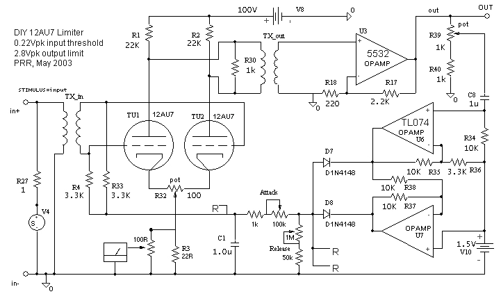

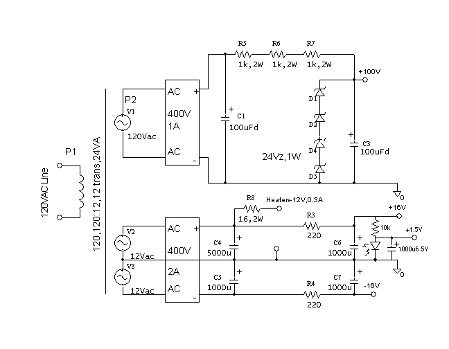

Oops. We're talking about two different PRR's here. :o I'm referring to this one: prr varimu compressor

The basic circuit is the same. The project I am building is the compilation of various mods which build on PRR's original circuit.
You will find some info here and here.
