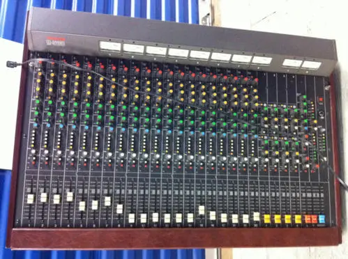

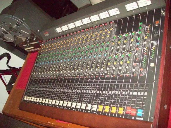

I came across a very, very sweet deal on a Tascam M320B mixer.
Finally after 2 months of waiting to go pick it up in N.Y.C.,..I made the the trip to Brooklyn yesterday, and met with the seller to pick this gem up.
I am very satisfied with my purchase, and I'm excited to start mixin' some new tunes with this badboy.:D

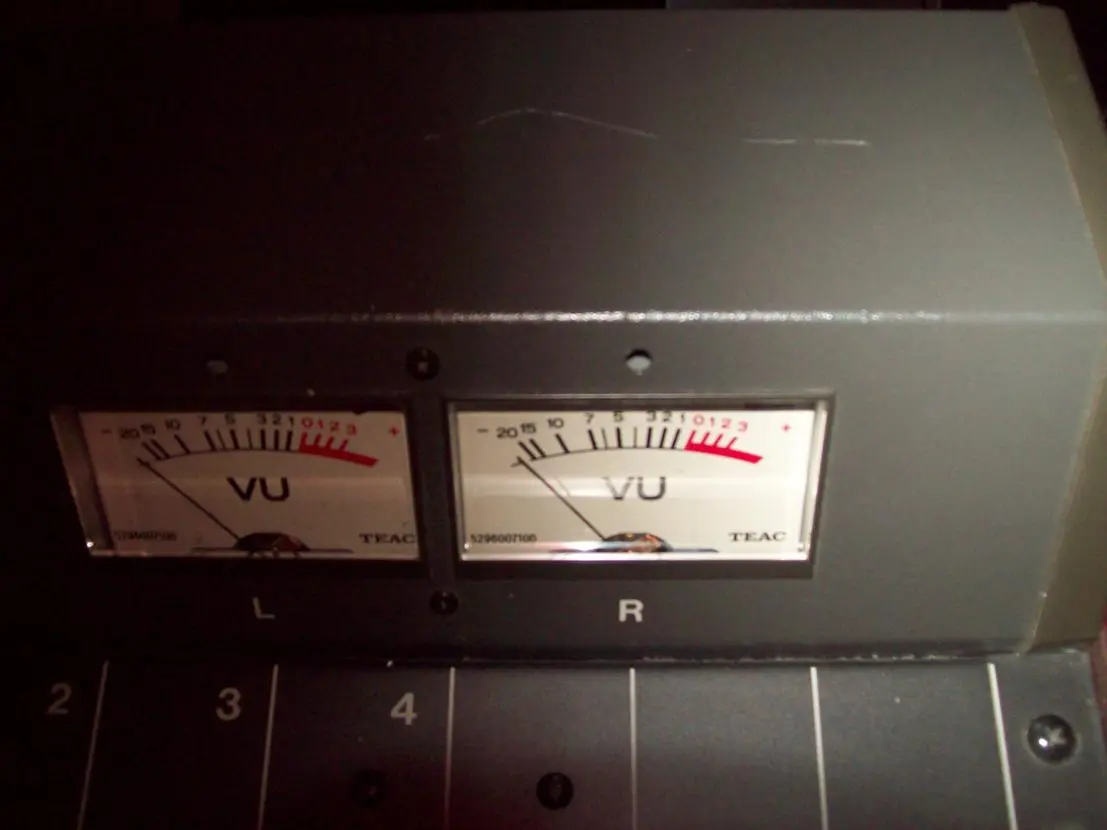

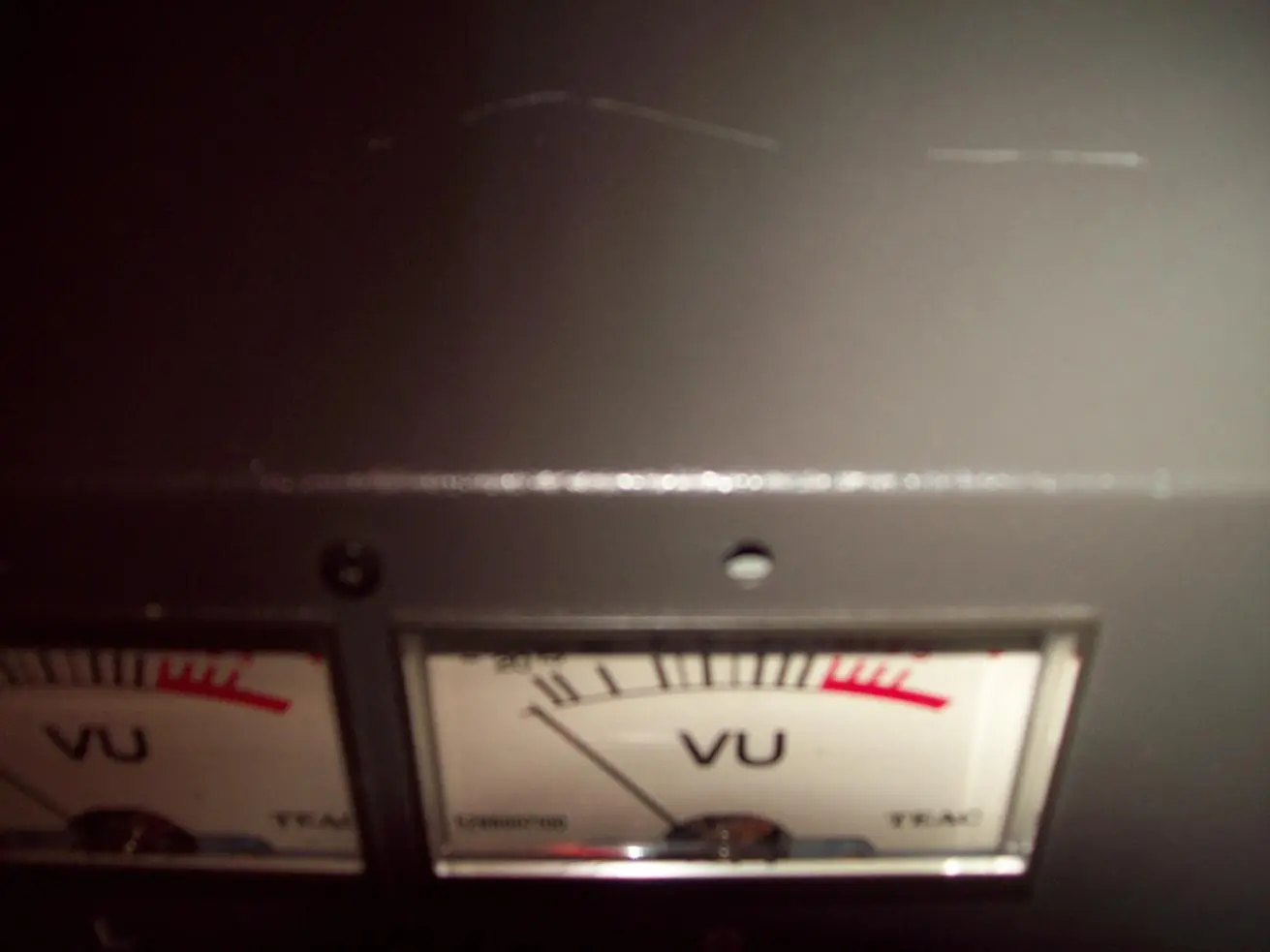

3) There's a significant sized scratch on the top of the right hand side of the meter bridge. Now, I am very anal about my gear, and how I take care of it...and this scratch is a very BIG eyesore every time I look at the mixer.
I didn't get the chance to clean it up yet,..but that will be my project for next weekend.

I tried taking a couple pics,..but I have a very cheap camera that isn't of the best quality.
I've also included a picture the seller took.

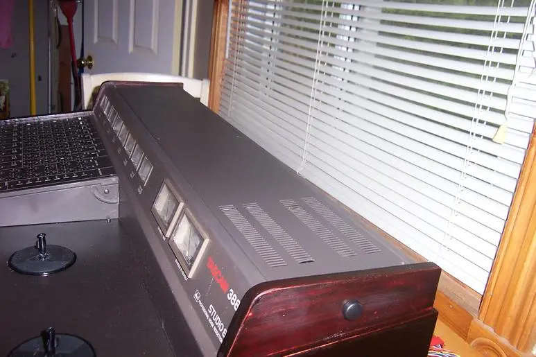

Just got back from home depot with a very close match for my 388.
I just took the top panel there and they scanned it with a spectrophotometer and mixed up a batch for me.
Im really pleased with the colour.
Im just using this on the top edge of the meter bridge,with a small paint brush to touch up.
I also found another close colour in a spray can that I decided to spray the whole card bay cover with.
Its called Rust-oleum universal Hammered finish paint. Brown Hammered is the colour
RustOleum.com
This sprays on with a hammered looking texture.It's not exactly the same 'splattered' paint finish as Tascam uses but it matches pretty well.
Just a quick update....
The spray on hammered brown paint turned out quite a bit lighter on the card bay cover.Still looks good though.
But the Home depot match is almost identical.So I might paint over the spray job once fully dried.
The Hammered finish looks good though and I hope it shows through when painted over.

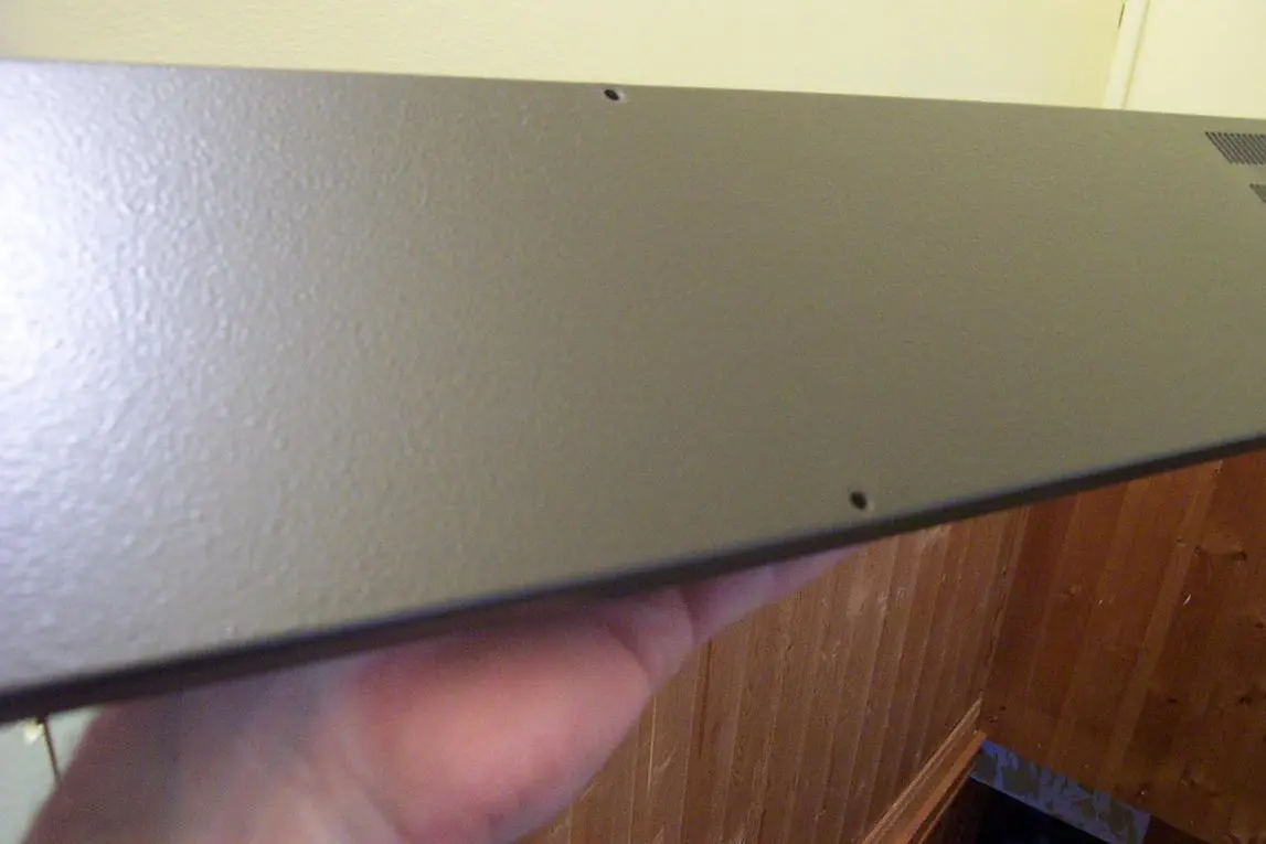

Ok.Here are the results of the Home Depot "Tascam Brown".
Looks really really close to me.
This is 2 coats painted on with a small foam roller.
Make sure you use a satin finish base.It's not too glossy and not too flat.

WOW! j.harv that paint job came out excellent!!!
Thanks for postin' the pics!
I think I'm gonna go for the Home Depot match!:D I think it may even look better than the original paint.
Yeah!
The more I look at it,the more it looks like an exact match.
Im really happy with it.And I got a quart of the stuff that I can use for future Tascam purchases ;)
