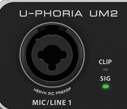

Well the Audio interface doesnt have a XLR jack, but a 1/4 jack so that why i got a female to male adapter to connect the XLR cable to the adapter to the Audio interface.
The input socket is a combo socket. It will accept 1/4" or XLR, but the connections made are not the same for each.
You need a regular XLR to XLR cable so your mic gets connected to the preamp, and phantom power supply.

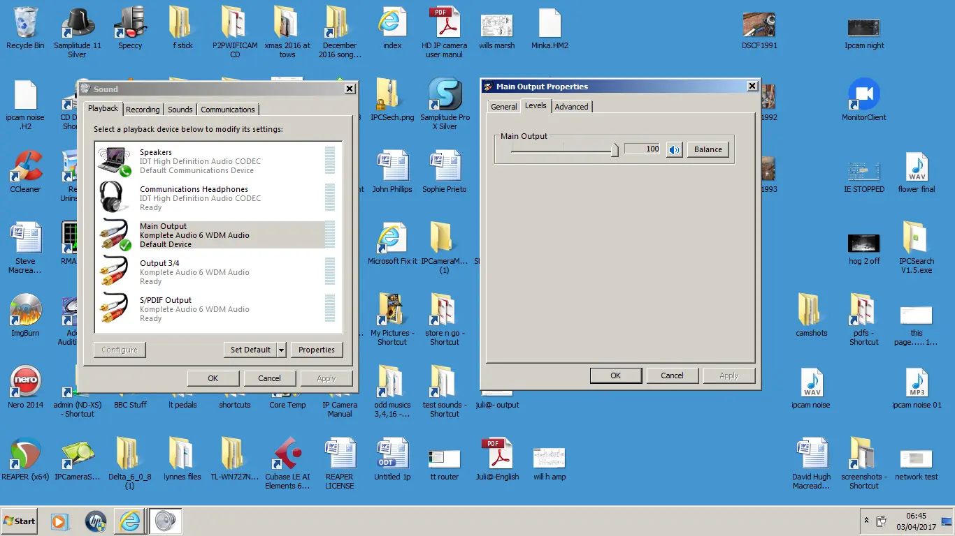

Attached is how Windows (7) shows the audio devices connected, or internal to the computer. The "KA6" refers to my Native Instruments interface and note it is marked as "Default Device". The Behringer should show as above or posibly as "USB CODEC". But that is not the end of the process, as you work through the menus you will find others settings, notably Levels. Playback should be set/left at 100% but Recording might need tweaking, down to 5% in some cases to avoid noise.
