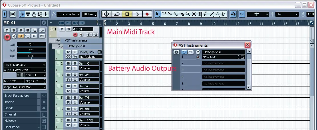

It automatically creates an audio track for battery under VST instrument in the main inspector window (see attached pic)
each of those Bat.1/2, Bat 3/4 tracks are batterys audio outputs and behave just like audio tracks so you can use inserts, eq's and so forth
