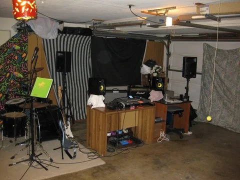

I am in your same situation although i have figured out what works for me. i have a two car garage, half of which is actually occupied by a car and the other half i use for my studio and rehearsal equipment. For sound treatment of the room there are two ways to go about it: the right way or the cheap way. I chose the cheap way :). i just hang up old blanket on every wall i can to dampen the sound. you could sound treat the room the right way by looking up some info on bass trap and insulation panels, but the sheets were free! you can see from the pictures i downloaded how my actual layout is. Main problem with garages is the room reverb. the blankets really do help with that portion of the problem. i record my band's live rehearsals i think by next week i'll mix this weeks rehearsal and put them up in the mp3 mix clinic to see what you think about the room sound and what others think. garage studio left.webp
