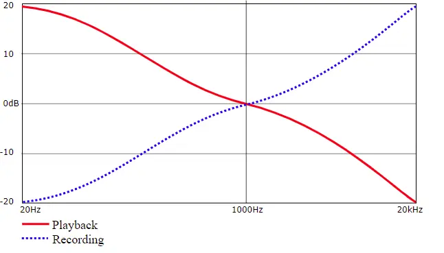

As I understand it, some of the early CDs were produced straight from the LP masters, complete with RIAA equalization. Of course they weren't getting played back with the appropriate inverse eq.
