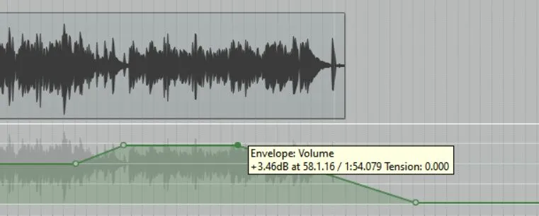

Something else to consider if you have a long piece with both quiet and loud parts, you can still "ride the faders" like you might have done in the old days. This is called automation in the digital realm. This would be an example. Say at the end of this track I needed to boost the final section and then fade out... it would look something like this:
In this case, I boosted the track by 3.46dB, and then faded it down at the end. You can be so precise that if you had a noise spike, you could set the point immediately before the spike, cut the volume at the middle of the peak, and raise it back after the peak goes through. I did this on a couple of records that I transferred. There was a slight scratch for a few revolutions, so I could notch out each click for the 4 or 5 revolutions that the click was heard.
