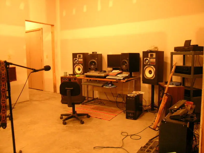

Hey Rick. My concern is isolating the floor above. I'll be running a drywall ceiling. I'll be testing different sound absorption panels to tame the room itself when basic construction is done.
I didn't have the benefit of directing some of the construction processes I would have liked; staggered studs, walls blown with insulation, etc. Now it's more like damage control! Wife and I fight while I'm listening to music and she's trying to watch TV upstairs! :D

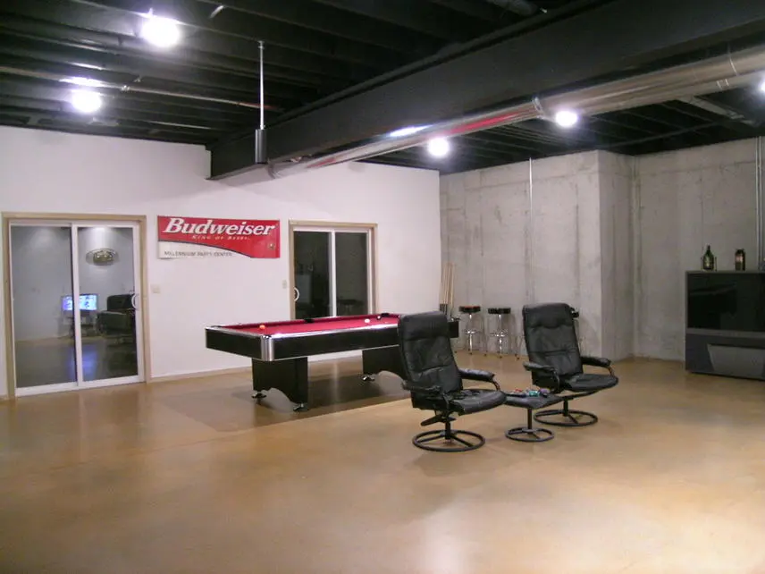

I used a water based stain on the floor in the bar I'm building around the corner from the studio. Super easy to use, amazing results! Easy masking, easy application, and uber-durable. I've got four coats of clear on it now. When bar is built, I'll roll two more just for good measure.
The hard part was spraying the open-beam ceiling. Masking project from hell, and what a mess!

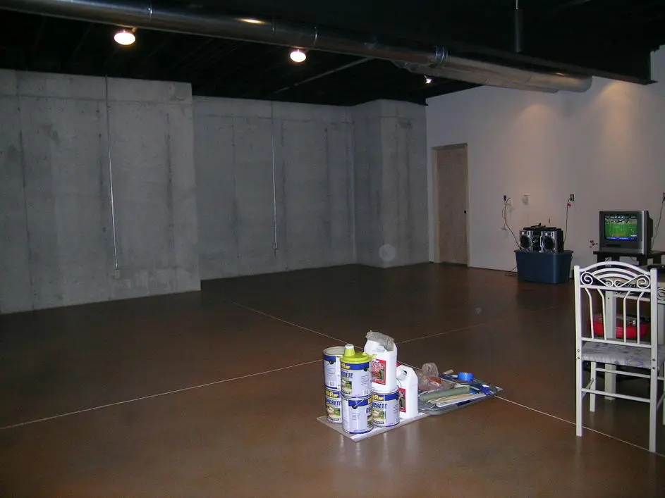

Well worth the effort, though. Built this house two years ago with a 1,900 square foot Man-Cave basement in mind. Last house had 7' ceilings and pole supports. Not this time! Wife has been very tolerant! :D

Disregard pictures of bar area. Two separate rooms. Floor fastened directly to joists. Assume "all the wrong stuff."

OMG! I hate you! :D
What a BEAUTIFUL environment. Good for you, my friend! Can I come over and play?

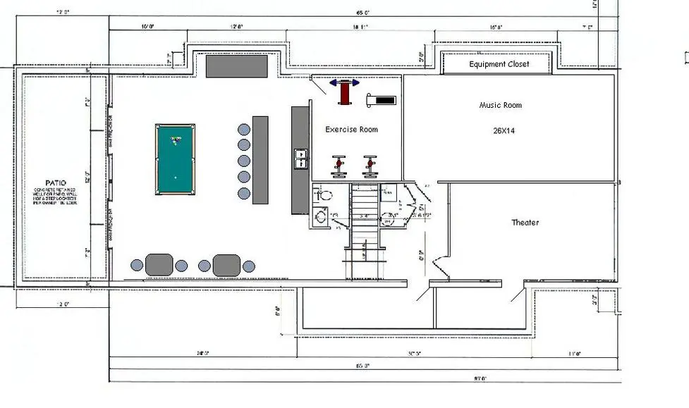

The room is a 26X14X10 "box" with attached equipment closet. Might use closet as vox room if needed. Either way, I'm installing a pocket door to maximize wall space.
Given the layout in the pictures, what type and size of panels would be advantageous?

First, you need to be WAY back from that front wall. The 38% point would be a little more than 9' from the front wall...given a 5' monitoring triangle that would put your speakers about 4' from the front wall.
At that point you should treat the room as you would normally: bass trapping floor to ceiling in all four corners, thicker bass traps on the back wall, then 2" high frequency panels at the reflection points and on the front wall. Since the ceiling is still a little low, 4" panels might be better above the mix position.
In the back of the room you should probably stick with 2" panels with diffusion striped between them or to the right and left side. I'd also look at doing the same thing on the right and left walls near the rear of the room, and maybe even striping some diffusion with the bass traps on the back wall in the same way. This will keep the room controlled, but lively.
