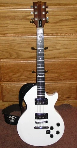

Actually, The Paul guitar from the late 70's has the switch located between the rhythm pickups volume and tone knobs, see the picture below.
And as old as the pots are, I would clean them while the controls are open.

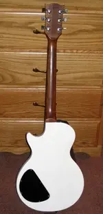

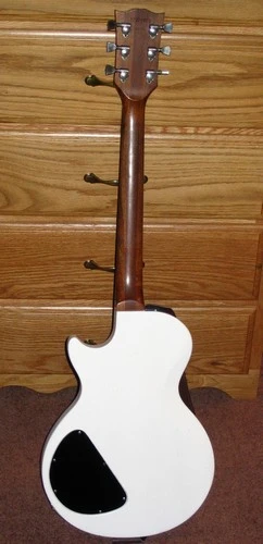

Heres the back, and the access plate to the controls.
