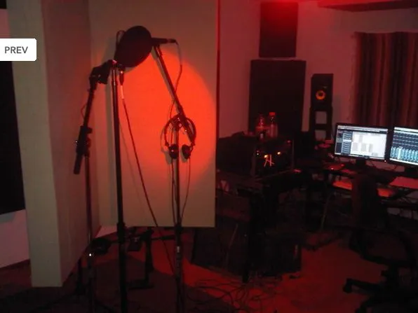

This is what I do. Hang panels from the ceiling. There are also Rockwool panels on the wall behind where the singer would stand as well.
