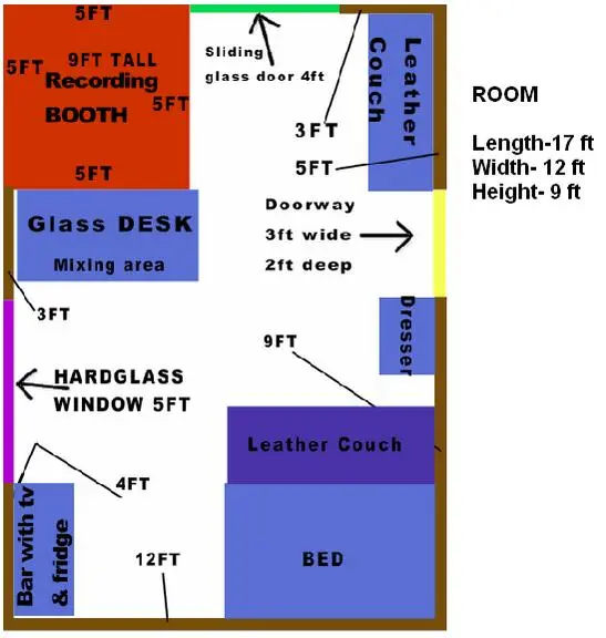

Well my KRK ROKIT 8'S G2 monitors with stands will be here around friday so I'm interested in learning about room treatment. I was told to make a drawing and it would help me get answers on what to do.
Attached is my attempted drawing with dimensions and furniture positions.
I have no idea as far as when people say "treated rooms" what they actually do to get it done properly so I'm hoping to get some help here?
Any advice?
(Correction, I've decided to go get the ROKITS today they in store now but I can't afford the stands just yet)
But, Seeing my room dimensions, do yall think ROKIT 8'S are going to be too big?
This was built in a garage so The back 12ft wall you see was put there custom it use to lead to laundry room I closed it off....... I'm willing to build a another wall somewhere in room for mixing purposes IF I HAVE TOO but prefer not too
I would consider this type of layout:
Rearrange the room.
Forget that coffin of a booth, it ill server little purpose other than to take up your precious room space.
Lose one couch...but keep the bar if you need to. ;)

Glad you're taking advice into consideration. :) You'll most likely get a more natural sounding vocal track in a large well treated room. Aside from that, I think you'll create a much better (and symmetrical) monitoring environment if you go back to a rectangular room. Based on your drawing, it looks like you have your corners open- a lot of rooms have doors and other obstacals in the corners, so that gives you some really easy opportunity to treat your room. Search here for "bass traps", rigid fiberglass and rockwool. These are things you'll want to use moving forward in luie of any kind of foam. Ethan's videos give some great insights into the theory and methods most HR people employ. Ethan used to be a regular member here (he still posts once in a while).

The vocal recording booth was built two walls thick with the pink fibreglass insulation put inside the walls ... carpeted floor, and acoustic foam on ceiling, walls, and door. It is 9ft tall and the walls are 5ft wide.

The booth isn't really adding any magic to the vocal...especially if you want to treat the whole room properly, then the booth in that size room is non-essential, and you have to think about the mixing even more than a vocal booth...and as-is, your mixing location is poorly placed...which is why I made the recommendation to move things around.
Without the booth...all you might need is a nice iso-shield to keep some room reflections out of the mic when recording vocals...but again, if you are going to treat the whole room...that might not even be needed...and you gain a lot of precious space (which is good for the mixing) by losing the booth and relocation your mixing position symmetrically in the room.

No, it's giving you a worse sound because you're in a smaller room, and foam makes it worse. Read up on acoustics a bit. I guarantee once you get over being in denial, you'll wish you never built a "booth". When you read about "vocal booths" in big studios, we're talking about "booths" that are probably twice the size of your whole room. I think the word "booth" throws people off and they imagine a phone booth or something.
Lose the booth...and then lose the foam. You're not doing anything good for yourself with that stuff.
