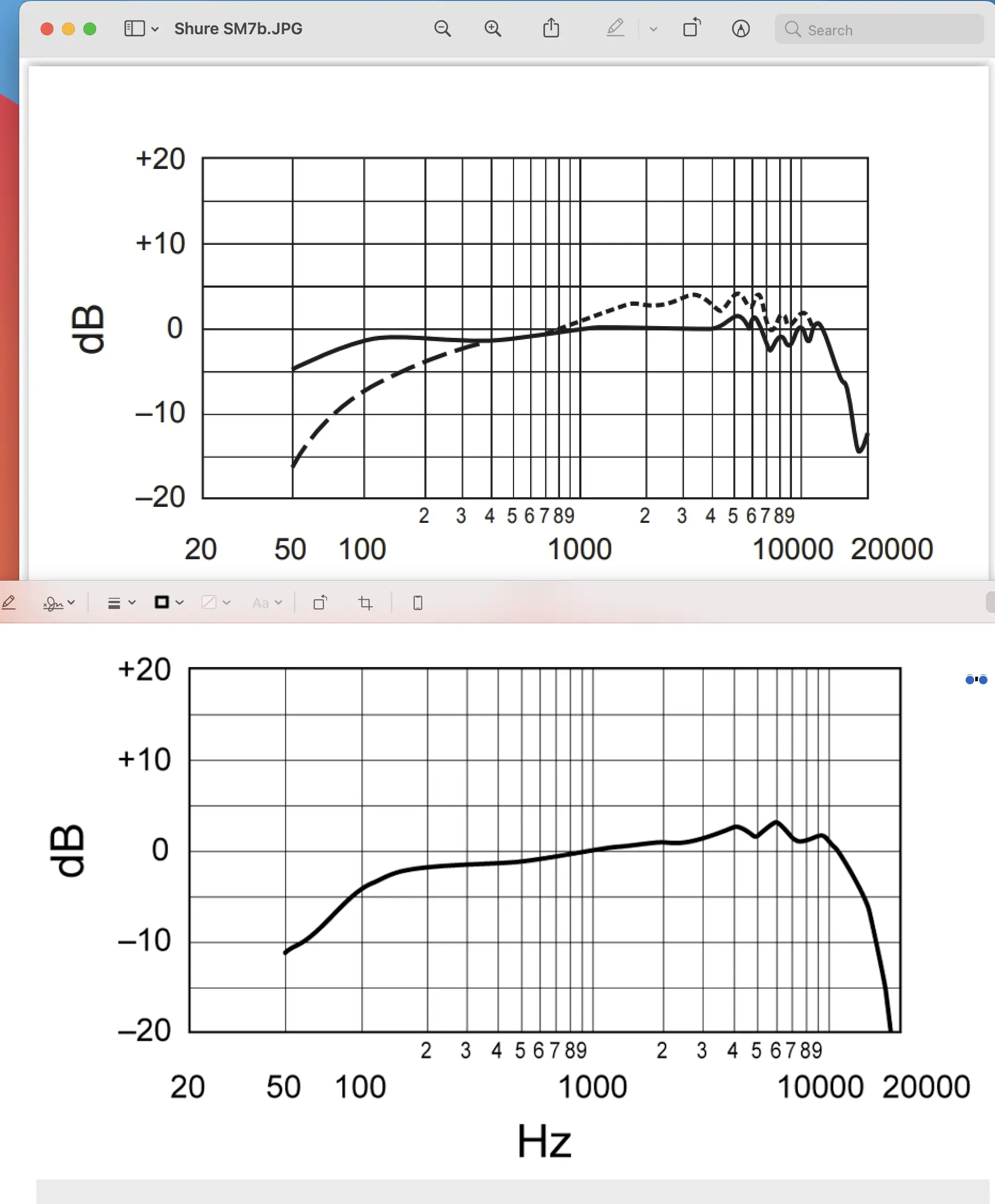

SM7B is going to need a preamp with a lot of gain or something like the Klark Teknik CM-1 or Cloudlifter if your interface doesn't have enough umph. It is a mic you'll either love, hate or be indifferent to. Biggest issue I run into with female voice is sibilance. Not knowing your voice, hard to advise. Here is the frequency response chart between the two with SM7B on the top. Heil PR40 is a good podcast mic. Tons of new cheap dynamic podcast mics, many getting good reviews. For really neutral the Earthworks Icon is at the top of your price list and is a great mic. Fill in the blank, the SM58 lacks (. )?

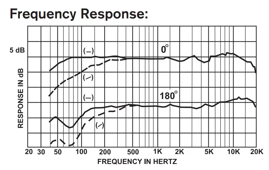

If you're spending money, then EV RE20 with a Cloudlifter would be my thought. High end lift is pushed out, and better handling of proximity effect than the SM7b. Do not go with the cheaper RE320.
Thanks for the suggestion! After looking into it, it seems that this is exactly what I'm looking for. :)
Never needed a Cloudlifter on my EV - output from speech is fine for me?
