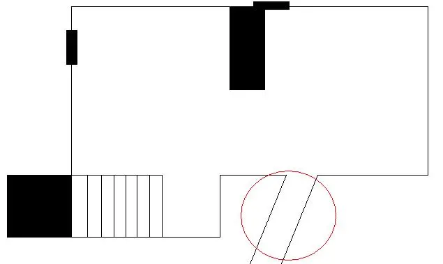

Before I'm able to take pictures, this is how it is:
You open the trap door and theres a 1 or 2 metre drop, after that stairs for about 2 or 3 metres then a big open space, parrallel to the left of the stairs is a wall and then an indentation in the room. There is 1 window (or 2 not sure) where the wall kindof of is sucked into it to make a dent. Attached is an estimate of the cellar (from the last time i saw it) Remember, walls are 1-2 metres thick, but there are those windows. Ill see if my dad will take me down there, I just told my mum and she thinks its a great idea as my dad ha sbeen wanting to convert it for ages.

Right, this pics have confused me. Are you sure your drawn pic is right? Pic 7 confuses me, is that bit full of stones etc the circled bit on the attached pic? If so, in your drawn pic, it seems you have missed the wall to the right of pic 7. Also is pic 6, the "indentation in the room" you mentioned, I'm confussed.
the bit you circled is a tunnel, the black rectangle si the stones in pic 6. To the right of the drawn pic is pic 7 where there is a short bit full of stuff. Nevermind the indentation, i messed up that.

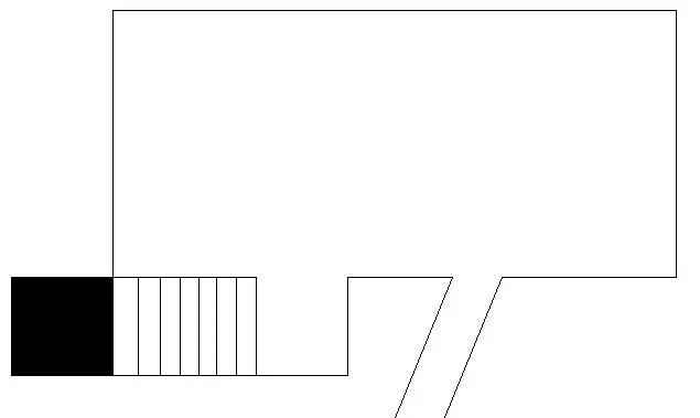

You think you'll be able to knock down the stones in pic 6?
So it'll be like this when you've knocked it down, filled in the window(s), and cleaned it up.
The tunnel goes to the war shelters, yes thats what It would look like in a few months.

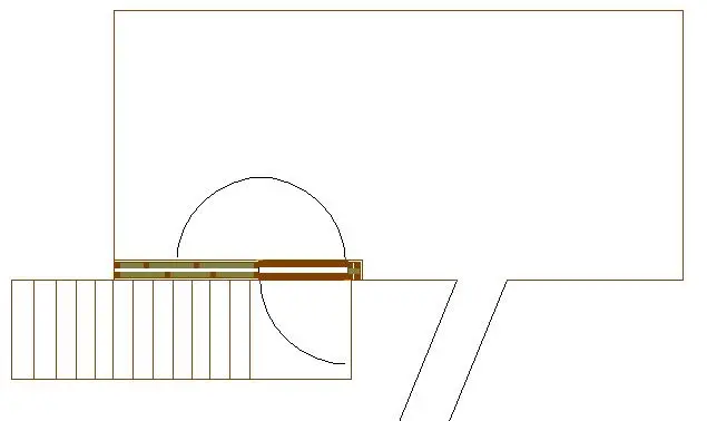

leak sound, ie where air goes sound goes. So if the war shelter leaks air, it will also leak sound. Yeah a door at the bottom of the stairway would be good, thats eactly what i was designing as i was getting more info. I'll show you what i have already.
