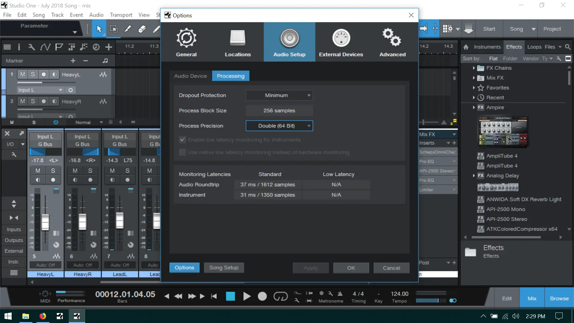

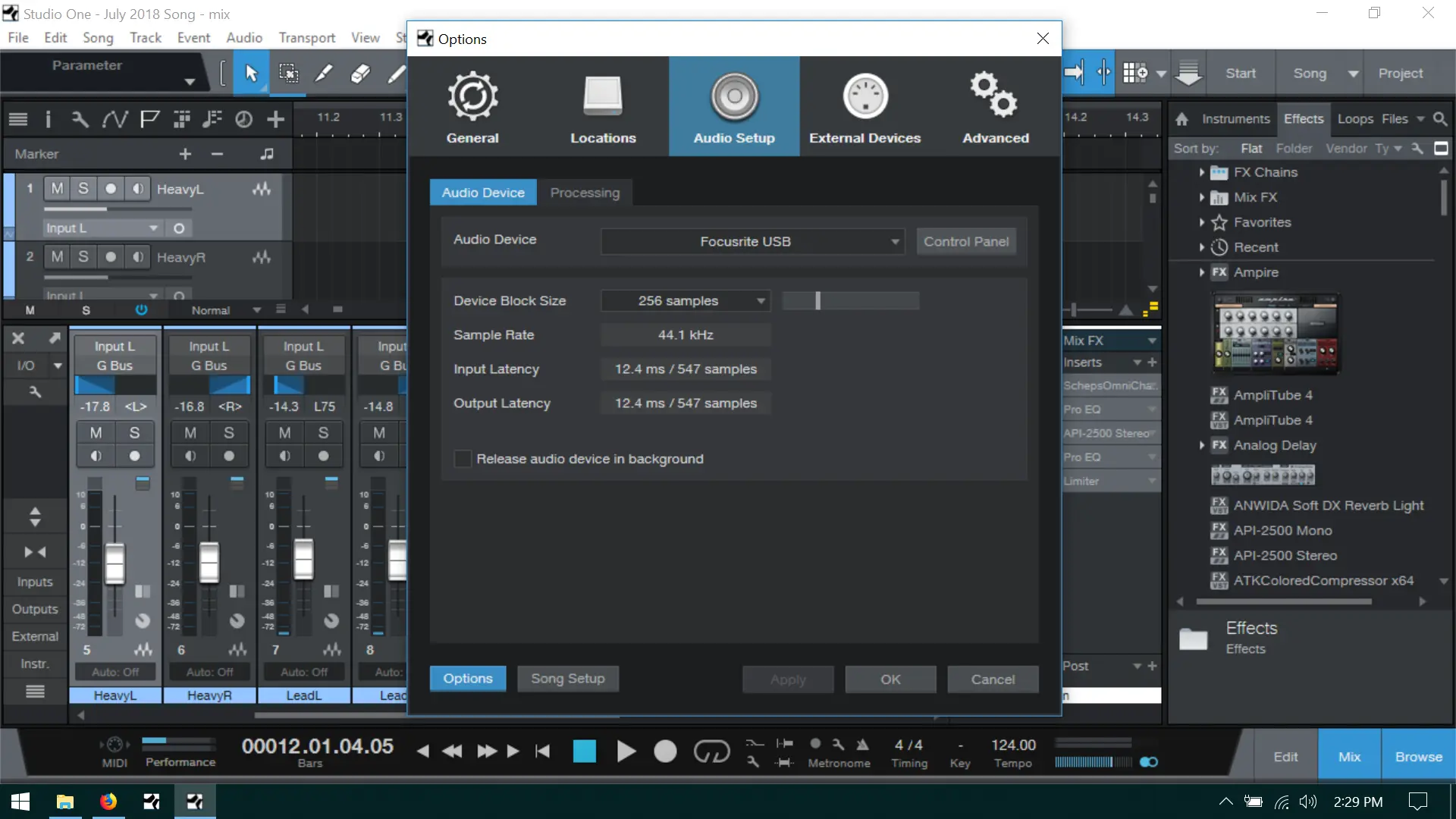

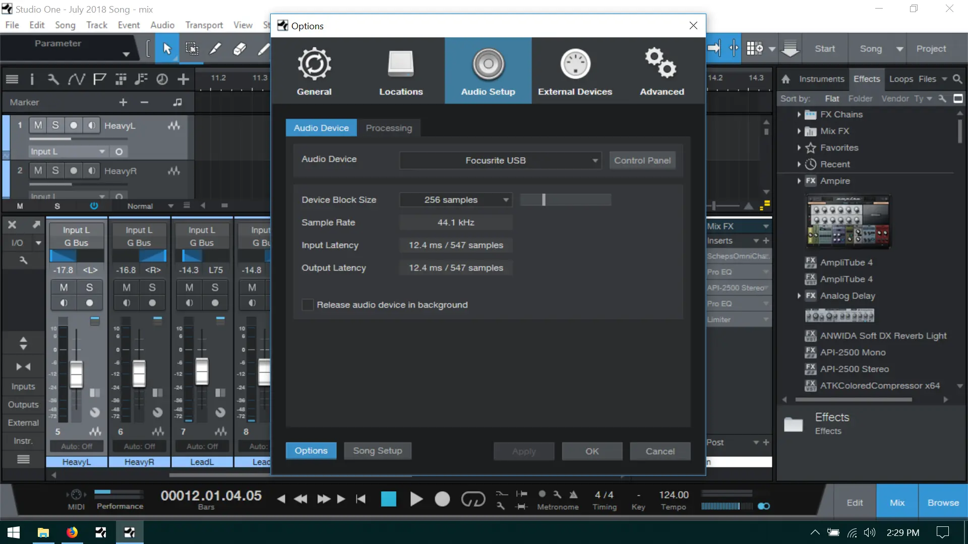

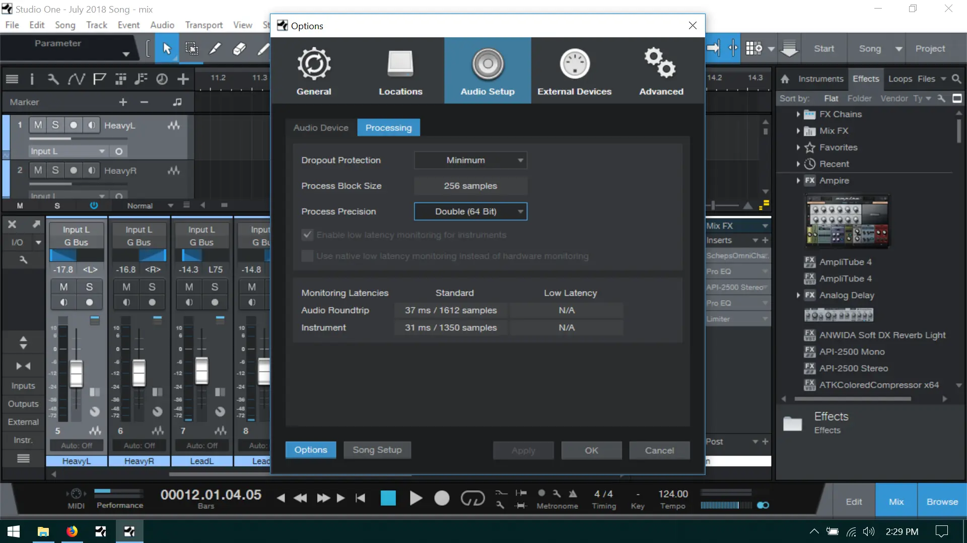

Is this it? If so, isn't it already telling me the correction value here? Again, if so, HOLY CRAP no wondering I have to do so much adjusting all the time.
Is that 31ms it? I don't see where I can adjust that via settings. Looks like I'd have to adjust the files over 31ms, no?

My "device block" is at 256. And it's showing 12ms input latency. I believe that, and not the monitoring processing, is the problem. Right? Because there's a delay with "input", it's going to write it incorrectly. But remember that it's writing EARLY, not late. Never ever has a note been late, always early.
Found something that says this:
"The aim when recording is to keep your latency as low as possible. This reduces the amount of delay between the time you play and when you hear it - this delay happens because the audio has to pass through A/D (analog to digital) conversion, be processed by Studio One and then back through the D/A (digital to analog) so you can hear it.
So set you device block settings to the lowest possible setting"
but I'm not looking to HEAR things sooner, just have them written later. The delay I HEAR is fine. Doesn't throw me off. The early plotting is the issue.
Just talking to myself here, til someone to reign me in chimes in. :)
I'm not sure what those are telling you*. Normally if the software accurately measures the out to in round trip it correctly compensates, so if you're having trouble with tracks lining up I wouldn't trust what the software says. In that case I'd do the loop back test to measure it myself then find the manual adjustment.
Input monitoring latency is different from record latency. That's in to out rather than out to in. Software can't compensate for input monitoring latency, it can only try to minimize it. But it can compensate for record latency, either automatically or through a manual adjustment.
*[Edit] I think those panels are talking about input monitoring latency.
